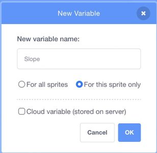

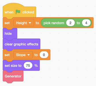

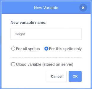

Ok time for programming, make two variables, name one Height and name the other, Slope. Now copy this (See pic 1):
when flag is pressed
set Height to pick random 2 to 4
hide
clear graphic effects
set slope to 0
set size to 75
After you copy this down you will have to go to “my blocks” (it’s red) and you need to make a block and name it “Generator” ,make sure it is running without screen refresh (makes it fast). Add the generator block to the pre-existing script.

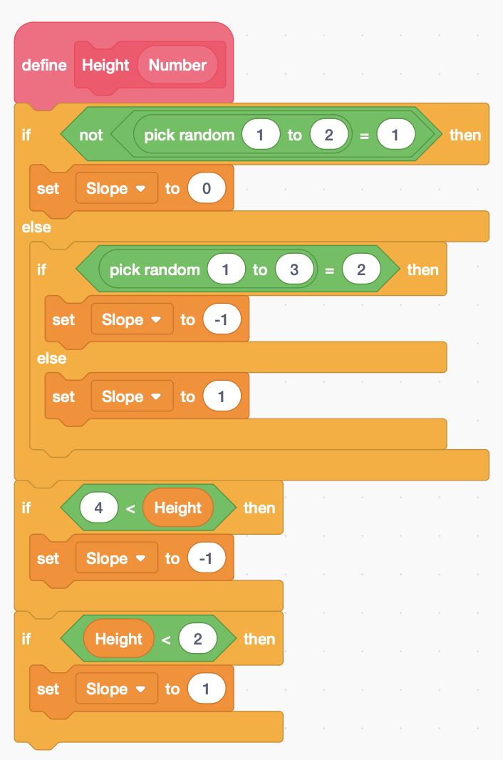

Yep another “my block” ,but it’s okay because this will improve the speed of the generator, and is the the last one.In this “my block” name it “Height” ,just like the last one make sure it is running without screen refresh, one difference though because there is an input for a number or text.
Now this is for the “my block” named “Height” (See pic 6):
Define - Height (Number)
if {not{(pick random 1 to 2)=1}}
set Slope to 0
else
if {(pick random 1 to 3)=2}
set Slope to -1
else
set slope to 1
if {4<(Height)}
set Slope to -1
if {(Height)<2}
set Slope to 1
