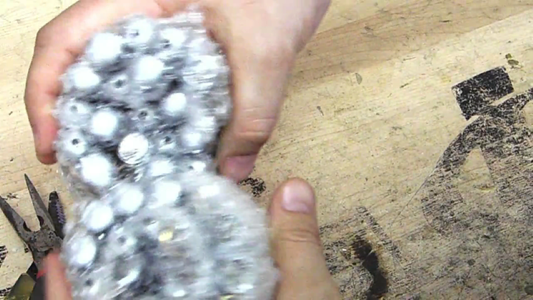

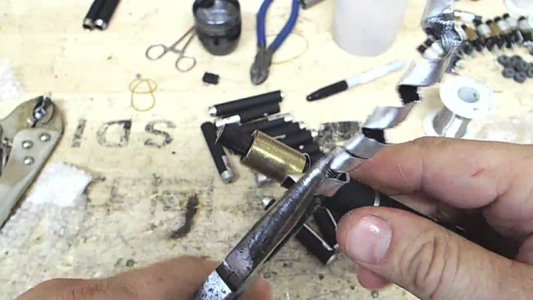

Extract the diodes from the housings. The best way I found is just to use a pair of needle nose pliers and peel away the casing from the outside. Its easy to do if you just give it a little twist.

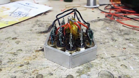

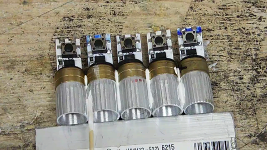

Epoxy them together in groups. I made 5 groups. A row of 5, 2 rows of 4, and, 2 rows of 3. When put all together they will make an even hexagon with 19pc total used.
Step 4: Step 4

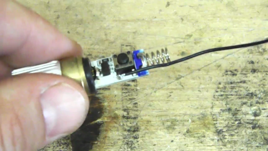

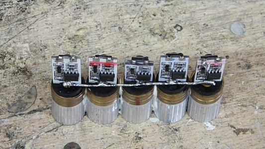

Wire the battery + and battery - circuits together in parallel. The battery + contact runs along the base on the back side of the driver board. The battery neg is the top switch leg on the opposite side.
Step 5: Step 5
Epoxy the strips of laser diodes together and put some aluminum flat bars around the outside for extra heat sinking (The strips are optional but a good idea because lasers generate a lot of heat).

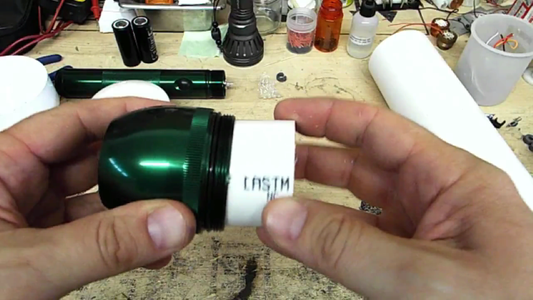

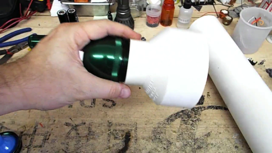

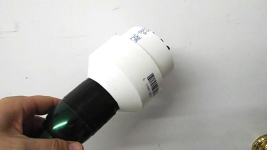

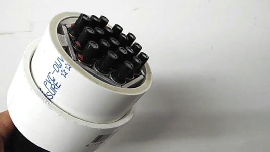

Create an expansion for the flashlight host (Maglite) using PVC pipe. This is a 3" to 1.5" adapter. Cutting a 2" piece of the 1.5" pipe and slipping one end into the maglite head (with the bezel removed) and the other end into the adapter makes a snug fit, no epoxy is needed. Also cut about a 4" long piece of the 3" pipe and slip it into the other end of the adapter.
Step 7: Step 7
Install the diodes into the housing and wire them to the maglite switch. You will only need 2 wires since we assembled the didoes in series.

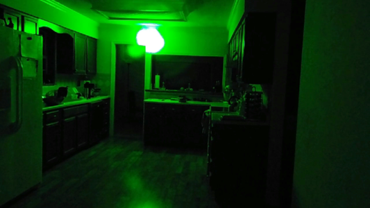

Wake up the neighbors! Remember even though these lasers are low power they do have the potential to be harmful to eye sight so be careful where you point it :) Having a set of laser saftey glasses is also a good practice. I Hope that you have enjoyed this experiment as much as I did!
