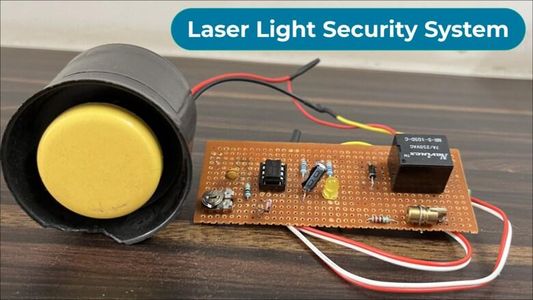

This article is about a laser safety system using a 555 timer IC and LDR. This project utilizes a simple yet effective combination of Laser Beam, LDR (Light Dependent Resistor), 555 Timer IC, Relay, LED and Buzzer to create an intrusion detection solution.

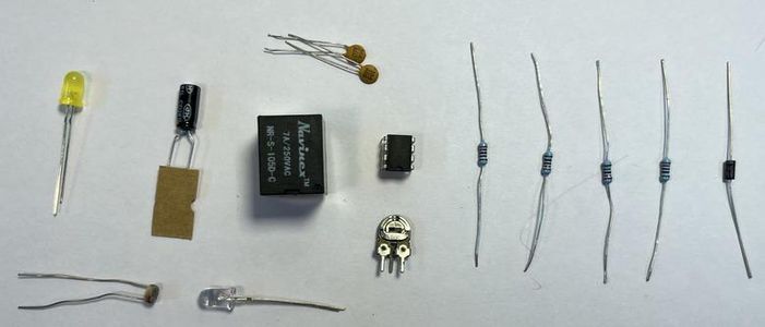

Here are the components needed for your laser safety system project:
555 Timer IC
5V relay
LED (any color)
siren or buzzer
Laser pointer or laser diode module
Resistance: 10K, 1K, 220E, 330E
Potentiometer 10K
Electrolytic capacitor: 10uF
Ceramic capacitors: 0.1uF – 2
Diode 1N4007
Breadboard or PCB
Jumper
Power supply (5V-12V)

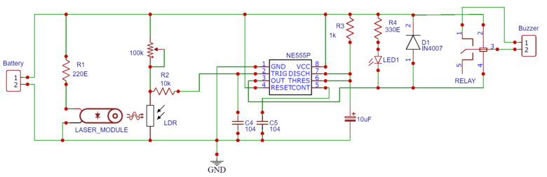

Step 1: Circuit Diagram and Connections
Figure 1 is a schematic diagram of a laser safety system designed using a 555 timer IC and an LDR.

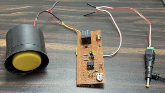

Here we need to set the 555 timer IC in monostable mode. Then trigger the 555 timer by connecting the LDR and potentiometer in a voltage divider configuration. We can then use the output of the 555 timer to drive a relay which activates the siren/buzzer and LED when the laser beam is interrupted (shown in Figure 2).

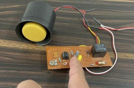

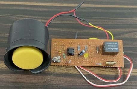

You can assemble the circuit on a zero PCB board (shown in Figure 3).

Laser safety systems using 555 timers operate by monitoring for the presence of a continuous laser beam. At the heart of the circuit is a 555 timer IC configured in monostable mode, which responds to changes in light intensity detected by a light dependent resistor (LDR). A laser pointer or laser diode module is used to provide a steady beam aimed directly at the LDR. The resistance of the LDR changes according to the amount of light it receives. When the laser beam is uninterrupted, the resistance of the LDR is low.
The 10K potentiometer is connected in series with the LDR to form a voltage divider. This adjusts the system's sensitivity to changes in the LDR resistance. When the laser beam is interrupted, the resistance of the LDR increases, causing a voltage change at the trigger input (pin 2) of the 555 timer IC. This change in voltage starts the monostable mode operation of the 555 timer, generating a pulse at its output (pin 3) as shown.
The output pulse of the 555 timer drives the relay through the NPN transistor. The relay in turn activates the siren (siren/buzzer) and the LED, indicating that the laser beam has been breached. The relay remains energized for the duration of the output pulse, clearly indicating a safety breach.
