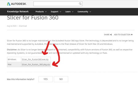

Step 1: Slicer for Fusion 360
The first thing to do before anything else is download Slicer for fusion 360 here. After installing and opening, you should be presented with the screen above. Click import and select the .stl file of your choice. Just make sure that it does not have to many large overhangs or to many small pieces that will make it hard to assemble. I chose A low poly bunny because it is currently the day before Easter as I am writing. Also because low poly models are often easier to cut out with a Hobby knife. I got my file here. A good place to look for files of this sort is Thingiverse.
