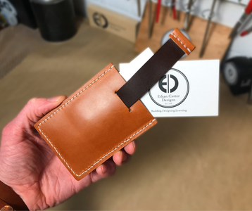

Ever since I first saw one of these pull tab card wallets, I’ve wanted to try to figure out how to make one, so that’s exactly what I did. The pull tab works by being attached inside the wallet to the back piece, and then it runs underneath the cards and out the front of the wallet. When the tab is pulled, the cards get pulled out of the wallet. When you push the cards back into the wallet, the pull tab retracts back into the wallet as well. Really simple, but a fun little detail to set your wallets apart! This could also be used as business card holder…just a thought!

To figure out the size to make the wallet, I started by making a template out of some cardstock
First, I traced a card
Then to make sure I had enough space for multiple cards and the stitch line I added a little over a quarter inch or 10/32nds to be exact, to both sides and the bottom
Next, I used the cut-out template to score some cut lines on the leather I was using
Once everything was laid out, I used my rotary cutter to cut the matching front and back pieces
Then I moved on to figuring out the pull tab that will be used to pull the cards out of the wallet
It then runs underneath the cards and out the front of the wallet
For the pull tab, I used a 3/4th of an inch-wide piece of leather attached an inch and a quarter from the top

Next, I moved on to cutting the slot for the pull tab to exit the wallet on the front piece
I ended up making the slot a half an inch from the top
To keep the leather from ripping, I punched a hole at each end of the slot and then connected them with my X-Acto
To attach the front and the back pieces, I again used Tandy Leather’s EcoWeld Adhesive
Then I pulled the strap through the slot on the front
I also added another piece of leather at the end of the strap to make it easier to grab and to prevent it from getting pulled back into the wallet
