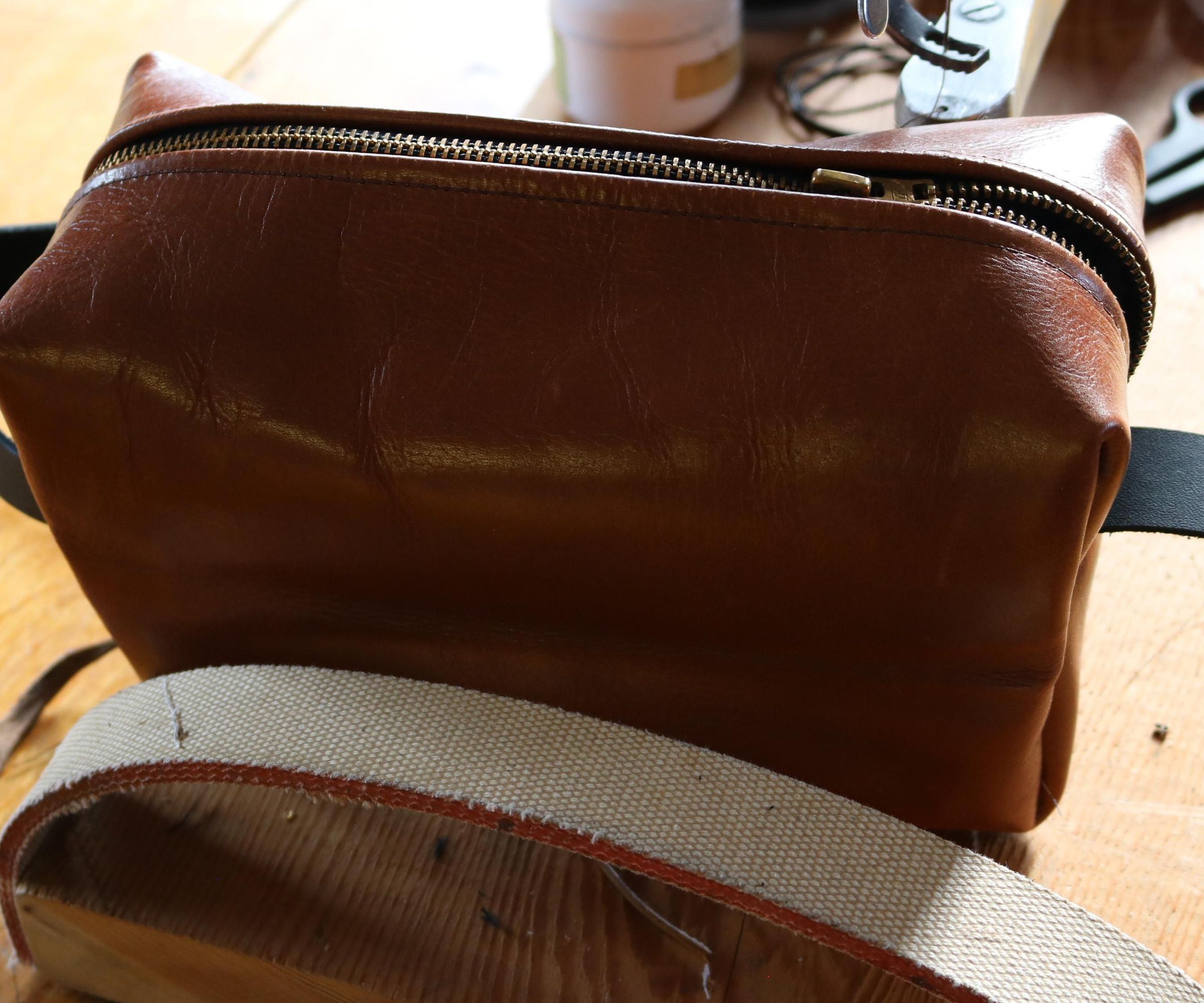

Today I made a leather watch strap from a scrap pieces of 4-5 oz leather. This is a piece of Laredo Utility side I got from Tandy Leather. I used the rest of the side to make a leather Messenger bag.
