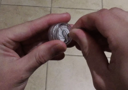

Step 4: Light It Up
Now it's time to attach the light and hanger to make the ornament functional!
The tea light should come apart into two halves. Take the half that has the actual light and put glue around its perimeter. Then, cram it into the opening of the ornament with just a little bit sticking out at the bottom.
In the meantime, you can glue the hanger onto the other side of the tea light. If you don't have a spare ornament hanger, you can use a paper clip. Just fold the hanger such that half of it is touching as much of the tea light as possible and then apply glue.
As a final "nice to have" touch, you can print out a small white cover that is the same size as the base of your tea light. To do so, you just generate a thin circle with a hole in the middle for the hanger to poke through. This is just to cover up the part where we could otherwise see the hanger glued to the tea light to help pretty things up a bit.
