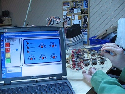

Having cobbled together loads of Arduino circuits and always found myself poking switches and potentiometers through cardboard I thought it was time to produce something a little prettier. So here is how to make a lovely little box to hold 5 potentiometers and 3 switches. (along with some software to make it work)
A simple video of spinning dials, causing them to spin on screen as well:

- Simply screw everything together and insert the potentiometers and switches.
- To wire up download the wiring diagram (05-POTB-Wiring Diagram.pdf). And run the wires to their respective nodes.

You can use your switch box in any way you like. What is included here is a small Arduino program that polls the Switch Boxes state and sends it over its USB connection to a computer (once every 100 milliseconds). Also there is a small program written in Processing to display the state of the box. The code is all highly commented to hopefully make jumping in and making changes easy.

- Start the program.
- Click on the Comm port your Arduino is attached to.
- Watch the dials spin whilst you spin yours.
