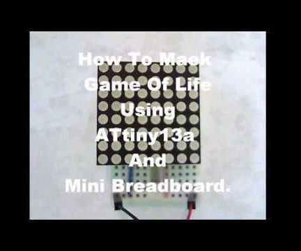

I made devices using ATtiny 13a to display infinite maze creation and escape routes.In this maze, This MAZE GENERATOR used a very simple "Bo - taoshi" algorithm for maze generation to generate a maze with 1 KB Flash memory.
"Bo - taoshi" algorithm decides pillars at even intervals to create a maze, and makes one wall for each pillar. Likewise, we draw a simple algorithm that draws out escape routes and blocks the roads surrounded by walls on all three sides. When the dot reaches from the upper left to the lower right, the escape route is displayed, so please escape from the maze by then.
