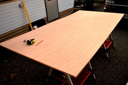

Step 2: Prepare the Base
Planning
Since this will not be a full size maze, remember that the effort required to add more rows and columns to the maze increases very fast. It will also get more and more expensive. Make all expense and effort related calculations early on before you even begin. If you don't have an idea of how many rows x columns you want in your maze, stop now and calculate it.
Preparation
I have decided to go with a 5 x 3 maze as it will suit my needs - calibration, testing and a reasonably large maze with multiple possible paths. Also there was a plywood board that was lying around that fit the needs. To be competition ready, I will need to run the mouse on a proper 15 x 15 maze to find any bugs that are brought on by larger distances to travel. But for now, this will suffice. For a 3 x 5 maze, I will need to drill (3+1) * (5+1) holes, ie. 24 holes with accuracy onto the plywood.
I drilled the holes using a drill press I had access to in a college. The holes have to be vertical and square. Using a drill press, I didn't have to worry about the vertical part - if you don't have access to a drill press, use a jig or a hand drill
Another problem here is that we need a square holes. As shown in the design of the pillar, the pillar's base fits into the square holes drilled on the base of the maze. I used a square tool with a handle to widen the round holes into square holes. You *could* try using a square file. Not sure how well it will work. Use whatever is appropriate.
