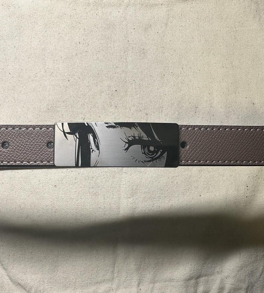

Introduction: How to Make a Mechanical Waist Belt Buckle
you can make a mechanical waist belt buckle
