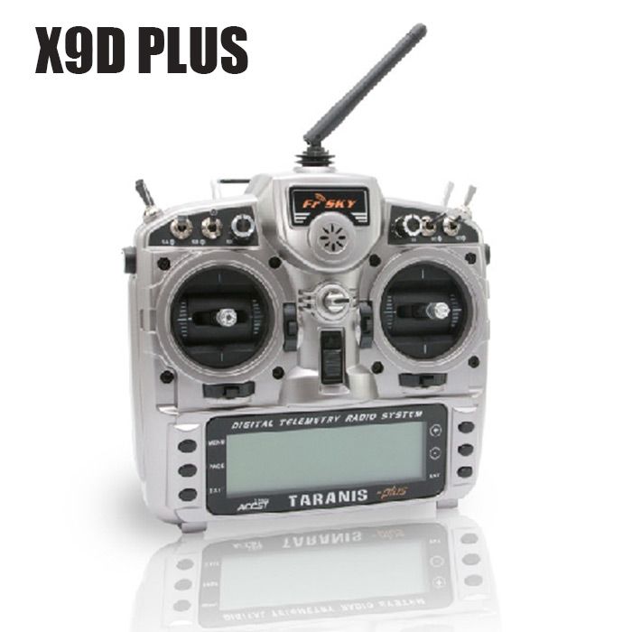

The reason this instructable took so long to make, was because trying to find parts that would work together was nearly impossible! In order to save you time, I've compiled the whole list below. One thing to note is that this project will require a Taranis or another FrSky Transmitter.

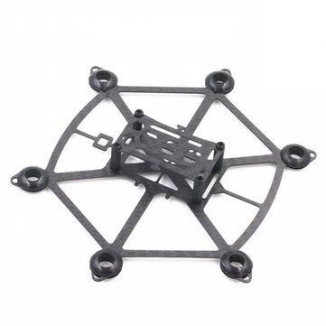

2. LANTIAN Spider 150 HEX-6 Carbon Fiber DIY Frame Kit: https://goo.gl/M8pbCf

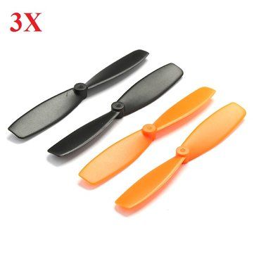

2. 3 Set Walkera QR Ladybird Blades Propellers: https://goo.gl/Zn43XO

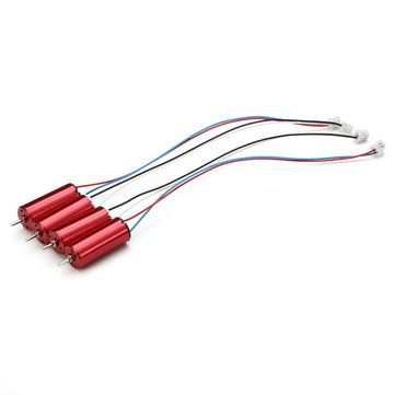

3. Racerstar 8520 53500RPM Coreless Motor: https://goo.gl/kN14i8

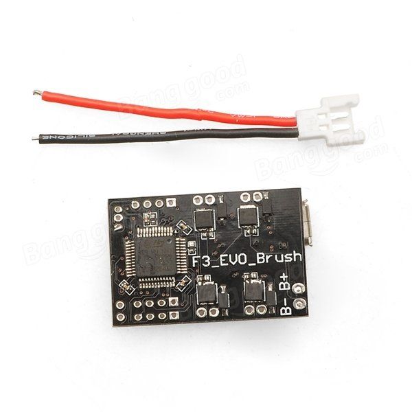

4. Eachine 32bits F3 Brushed Flight Control Board: https://goo.gl/vbSvuH

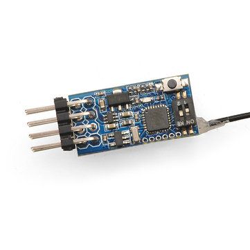

5. Tiny Frsky 8CH Receiver: https://goo.gl/RFVvYI

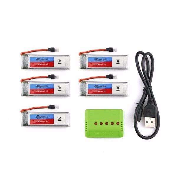

6. Battery: https://goo.gl/5sPHWz

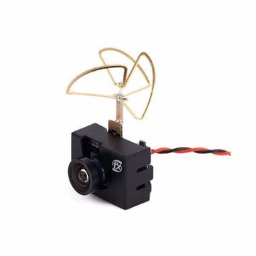

7. FX FX798T 5.8G NTSC Mini Transmitter Camera Combo: https://goo.gl/7fhFS0

The first step in building the hexacopter is to arrange the motors. Designate one side of the hexacopter to be the front (I used the side with a tab to add the fpv camera onto) and place the motors according to cleanflights Hexacopter X formation. The RED and BLUE motors are Clockwise with Red being Positive Blue being Negative
The BLACK and WHITE motors are COUNTERCLOCKWISE with Black being Negative and White being negative
Take the motors and align them onto the hexacopter frame in the correct order (Motor 1: CCW, 2: CW, 3: CCW...)
ccccccccccccccccccc
however you do need to be careful when soldering the motors to the controll board. If you look carefully, you will notice that the motor layout on the flight controller goes1,5,2 then 3,6,4. On the other hand, cleanflight's Hexacopter X goes 1,6,2 then 3,5,4. To solve this, follow cleanflights configuration and wire the motors across (Swap 5 and 6)
Step 3: Soldering
Now its time to connect everything together! Turn you soldering iron on and strip/tin the motors leads and solder them to they're respective spots on the flight controller. At the same time, add the lead to connect the battery to the flight controller. Next get the receiver ready. On the reciever in the (SBUS section of the board) You should notice 3 tabs: S + and -. Now on the Flight controller look for the UART 2 Section and you will notice a square tab followed by two more tabs. This is the - + and S Input section, and all you have to do is solder them up! (S to S, + to +, - to -)

Next, Plug a battery into the flight controllers battery connector you just soldered on. If everything was correct, you should see LED's on both boards lighting up. Unplug and re plug the battery, but this time, hold the bind button on the receiver down. While holding the button down (It might turn into a tricky twister game) grab the taranis and create a new model. Hit page and go scroll down and change the mode to D8 and then hit Bind. The receiver and Transmitter bind almost instantly and you can now unplug the battery and turn off the bind function. Re plug the battery and if the LED is solid green, that means the receiver is bound!

Now plug the Hexacopter into cleanflight and flash with the latest SP Racing software. Then connect the board and set the board up in the hex X formation. Go to ports and enable Serial RX on UART2. On the reciever tab make sure the option is on RX_SERIAL,and then set up the receiver brand with SBUS. You should be able to see the channels moving correctly in the little boxes. In the modes tab, don't forget to assign a switch to arm and disarm the hexacopter. Next go to CLI and type Type: set motor_pwm_rate=32000 and then type: Save.

In my last micro quadcopter tutorial I felt like I wasn't so clear on how to add FPV. I hope this sums it up better! Take the micro fpv camera and transmitter and cut the plastic connector off. Then strip and tin the leads and solder them directly to the battery input tabs of the flight contoller. This will give the camera the 3.7 volts it needs to operate. Then plug in a battery and check if the LED's light up. If so tune the frequency by using the buttons on the cameras body to match up with your fpv goggles. Then using some hotglue, mount the camera to the front of the hexacopter.
To add propellers just put clockwise props onto the clockwise motors and counterclockwise props onto counterclockwise motors then simply push them into place. Dont press too hard or you could damage the motors however.
