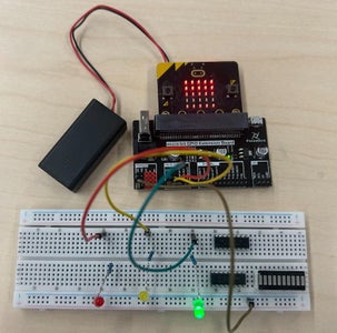

1 microbit
3 LEDS
3 extension ground wires
1 microbit extension board
4 wires
1 breakboard
1 battery pack

Gather pieces required to set up microbit
Step 12: Set Up Microbit
Place microbit in extension board. Connect wires.
Step 13: Play Test
Turn on the microbit and check that the program is running. You should see a green light, and a solid LED block.

Step 15: Yellow Lights Will Flash
Green light turns off, yellow light turns on, LED screen flashes
Step 16: WALK
Red light will turn on when the yellow light turns off and LED screen will project "WALK"
Step 17: Countdown
LED countdown from 9 to 1.
Step 18: Flashing Lights
LED panel will flash
Step 19: Resume Green Light
Red light turns off, LED stops flashing, Green light resumes
