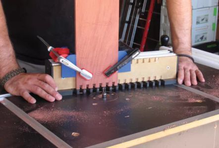

I selected the best grain orientation and marked out my box carcase pieces in preparation for dovetailing. I used my Gifkins jig for this operation in conjunction with the A10 template (photo 5).
After dry fitting the box and wrapping masking tape around the carcase as an additional safety measure, I inserted the rebate cutter into my router table and brought the bit’s top cutter flush with where the outside of the panels would sit. This ensured the lid and base panels would be flush with the box sides. I undertook the routing (photo 6) in two passes to achieve a nice, clean rebate.

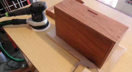

I examined the box for any imperfections so I could address them prior to applying any finish. I did experience some tearout on my lid panel which was no surprise as it’s figured and has interlocked grain. I used my HNT Gordon A55 smoother plane which is bedded at 55° to remove the tearout and create a clean and smooth surface. I find the higher angle of these planes produces a much better fin- ish on figured timbers compared to a regular plane that is bedded at 45°. I sanded all components of the box to 1200 grit (photo 17) and rounded over all edges.

A coat of thinned shellac was first applied and al- lowed to dry overnight. I then applied a generous coat of Livos Kunos oil (#244) that had been thinned at a ratio of 50/50 and wiped off any excess after 20 minutes. I allowed the box to dry overnight and repeated this process a further three times allowing at least 12 hours drying between coats. I used less oil for the subsequent coats than I did for the first.
I lightly sanded the box after the second and third coats to remove any rough texture left by the previous application of oil. A final buff produces a long-lasting finish that can easily be renewed with an occasional application of oil. This box was designed to hold medals, but will equally serve to display and safeguard other items of value.
