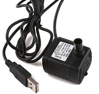

  6. Mini fountain pump.

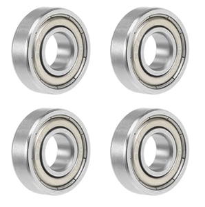

  7. 697ZZ bearings I got mine from a vacuum motor.

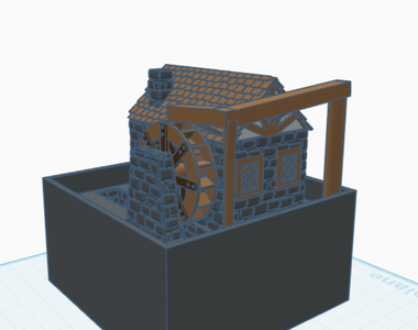

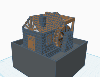

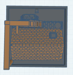

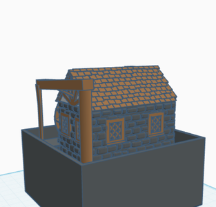

Step 2: Designing the Model on Tinkercad

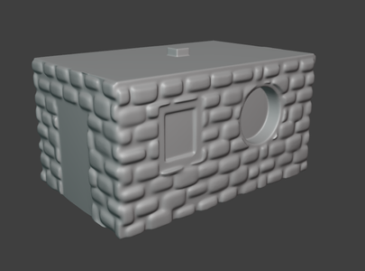

The first step i to make this model in Tinkercad was to design the model into Tinkercad. The finished model is about 110 x 110. If you want to design from scratch, I would recommend using the BrickWall part. It will save you a lot of time trying to make your own bricks, and It looks great! If you want to edit any of the parts, here is the link.
Step 3: Blender Smoothing, Sculpting, and Decimating!

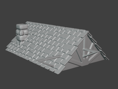

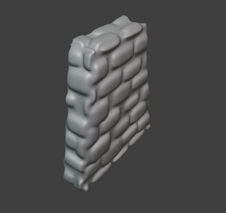

The next step I took was to take everything into blender and smooth it, I did this to give it a slightly more polished look and to smooth the corner where the different brick patterns meet. Then I used the Decimate modifier to downsize my files to 25MB. You don't have to downsize the files but it will make it slice faster.

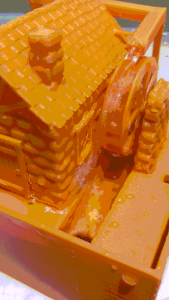

Step 5: Printing.
For this step you will need to have access to a 3d printer. If you do not own one, you have a few options. You can get it printed by companies like PCBway or you can use a makerspace or library printer. I am printing my part with a cheap orange pla filament that I have. Some of the parts may be hard for some printers to print, so I would recommend keeping on eye on the prints. For me it took about 8 hours.
Step 6: Assembly
Use the soldering Iron to fuse all of the parts together, you can use the photos or the Tinkercad viewer.
Step 7: Final Thoughts
I really enjoyed making this project, my printer isn't great, so It wasn't the best. I found that you need to turn down the slider on the pump so that the water doesn't spray too far. I also found that It was a good idea to make a little splash shield so that the water didn't splash out the back.
