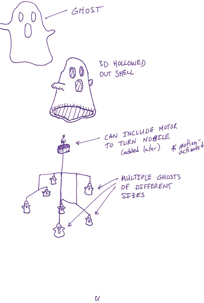

Step 2: Sketching Out the Design
The original scale of this concept was to just design a glow-in-the-dark ghost. My over-caffeinated mind took this idea and ran with it. "Why stop there?" it said, "Many cute ghosts are better than just one! And why not make them fly?" So the idea of creating a mobile to make the glowing ghosts fly came to be; which led to the idea of motorizing the mobile; which led to the idea of using a beam-breaking detection circuit to start the motor; which led to the the idea of using a light to "charge" the glow effect that would turn off when the beam was broken; which led to the idea of adding a spooky sound-track that would start playing when this happened. And who am I to ignore myself?
The point of all of this is that putting your thoughts down on paper can lead to a much more interesting design than just jumping straight into making something. If you don't already do this, give it a try on your next project.
Now that the basic design is completed we can start making something!

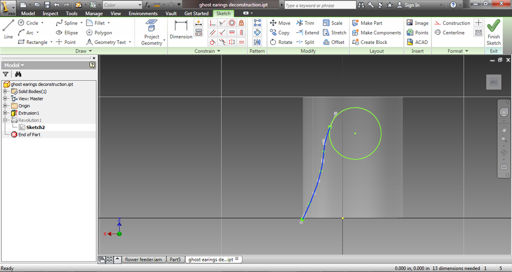

Step 3: Roughing Out the Ghost Body
Next create a work suface that is aligned with the vertical extrusion and the x,y plane. Draw a circle ~3/4" in diameter located at the top edge of the extrusion. Make sure that the circle is a little off center--you will see why in the following steps.
Now, using the spline tool create a moderately squiggly line that extends tangentially from the circle you drew down to the bottom corner of the furthest edge of the extrusion.
Draw a line that extends perdendicular from the top edge of the extrusion, through the center point of the circle and down to the bottom edge of the extrusion.
Next draw a line connecting the bottom point of the line you just drew to the bottom point of the spline you drew. This last line will create a closed shape that will be the profile of a revolving cut procedure to create the ghosts shape.
Trim away the remaing line segments we will not use for this profile.
A rotational cut of this profile should now be performed using the vertical line as the rotational axis and the "outside" shape as the face. You want to have a "lopsided" revolve such that there is a long flat region on one side of the extrusion. The illustration shows this more clearly. If this area is too small adjust the sketch that formed the template for the revolve operation to one side to increase this area.

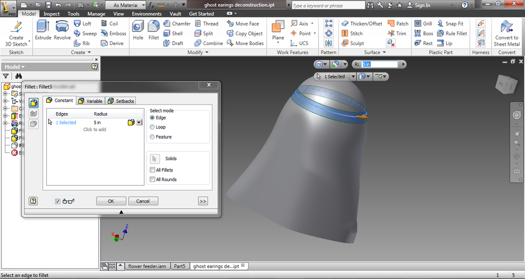

Step 6: Smoothing the Edges Over
Select each edge one at a time and adjust the diameter of the fillet until there is a smooth transition. Make sure you do this for all portions of the model that have an abrubt transition or hard edge. The following images show where my model was smoothed out.

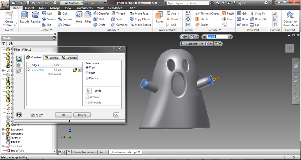

Step 7: Adding Arms to Our Ghost
Now create a work plane based on the "Tangent to Surface Through Point" method. Select the model near the point you created followed by the point itself.
Create a new sketch on this work plane and draw a small circle on the body just below the center of the mouth.
Now extrude this circle so that it connects with the model and extends out from the model a little bit.
Repeat this process for the other side.
Finally smooth the joints where the arms meet the body using a fillet process and round out the "hands" using the same tool.

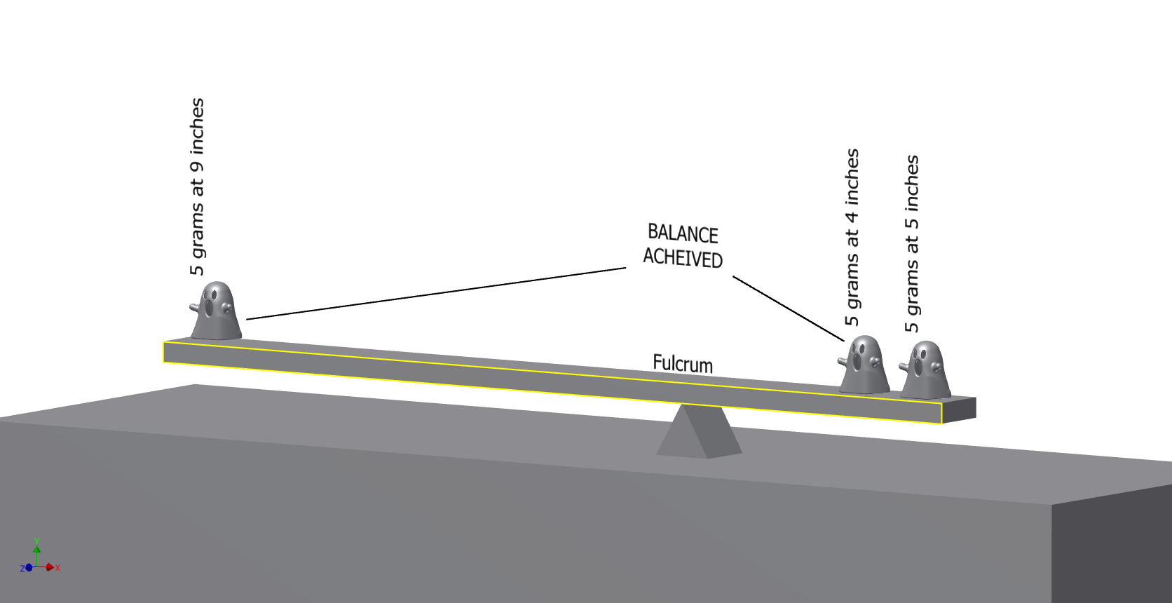

Step 10: How Much Does a Spirit Weigh?
As an example, if you have two ghosts--one weighing 3 grams and another weighing 9 grams--you will need to place the 3 gram ghost thrice as far from the fulcrum as the 9 gram ghost to balance this group. Each additional ghost added to a side will add to the equation. Example 2: 5g ghost at 5 inches plus 1g ghost at 15 inches will balance with a 4g ghost at 10 inches (5*5 + 1*15 == 4*10)
To figure out where the balance point is for each fulcrum will be you must first weigh each ghost. Since each model is slightly different in size each will be slightly different in weight. Measure and write the weight of each model on a piece of tape and stick this lable to each model. It does not need to be exact, just approximate to help when assembling the different groups of ghosts and their relative position with resect to their shared fulcrum.

Start with the bottom tiers as you will need to take the total weight of each tier into account when balancing the tiers that they are attached to above. Once you have defined the groupings and approximate placement figure out where you want the fulcrum in the tier above it and add any additional ghosts that may be needed to balance out this level.
Remember that the total mass of a tier is what will be taken into account for the applied weight on the tier it is attached to. Include this in your sketch and it will help you to estimate where you can add weight to balance out the design.
For my design I stayed with a simple three tier design, but you can apply this process to as many tiers as you like.
