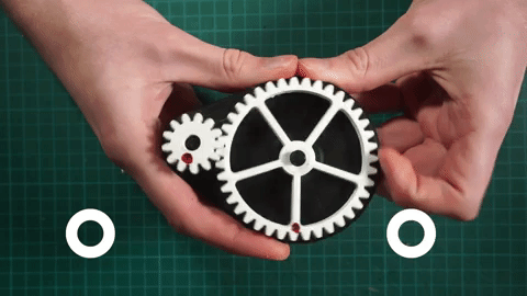

Because the tiny DC motor is too fast and too weak, we will need to find a way to convert its mosquito vibes into something more beetle feeling: and that's where gear ratios come in!
If we connect two gears, one with 10 teeth and one with 30 teeth - the first gear will need to make three turns in order to transmit enough rotation to make the second gear turn a full revolution. So we get a final speed that's three times slower than the initial speed. And also, here comes the magic part: the final motion has also three times more torque!
That's why the motor I'm using has that metal cube made of gears connected to it - it's a gear converter, and it slows the initial speed down to give us more torque.
The mechanism I designed also works on the same principle: reduce speed and add torque.
The other problem the gears will solve is the slight issue in the orientation of the spinning axis: the motor is horizontal, while the spinning axis of the turntable is vertical. To solve that issue, I placed two beveled gears right after the motor.
Step 7: Glueing the Big Gear in Place
Here comes the hardest part of this whole project: connecting the big gear in place.
The tolerances are very tight, and even a 1/32 inch variation can play a role in the final outcome of the project.
The big gear will need to be attached relative to the center of the spinning mechanism, not the plate in general! That means, that we can't just find the center of the plate, we need to focus on the mechanism:
First, remove the stand of the turntable. Mine had a hole through which I was able to access all the four screws that held the mechanism in place.
Then, draw two diagonal lines to find the center of the square formed by the four screw holes - that is the point we will be using to mount the big gear!
Using a compass, I was able to draw the outlines for the big gear, which I then glued in place with some superglue. If you wish, you can also add some screws for a more secure connection.
