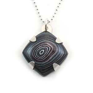

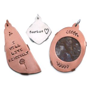

Learn how to do Tab Setting, also known as Turtle Setting. It's an easy way to set a stone without using traditional soldering techniques. Beaducation Instructor Aisha Formanski will walk you through how to saw out your metal setting, add design elements to make your piece truly unique, and to set the stone using unconventional tools. Pull out those stone cabochons you purchased at the last bead show, and lets get started! This class has a run time of 29 minutes. As always, if you have any questions or need any help, please contact us via Instagram, Facebook or email us directly, cs@beaducation.com. Find everything you need for this project here:
