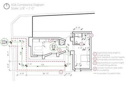

In particular, this project aimed to create an auxiliary dwelling unit for our campus. It would be used for visiting professors and other temporary guests on campus. Four of the primary drivers for the design were: accessibility, sustainability, passive strategies, and design integration. In addition, it would be used as the university's' way to get their foot in the door with sustainability and set goals for future projects. By creating a net zero building, the university could prove their equitable future.

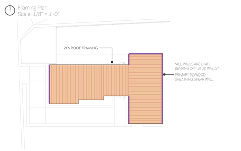

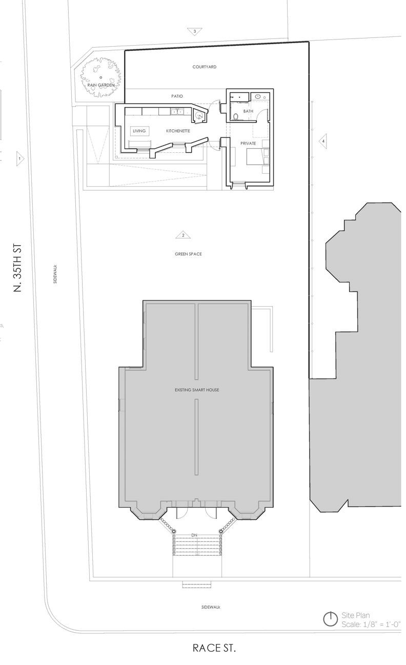

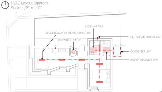

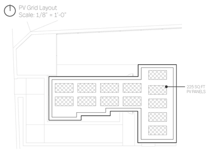

Step 2: Site Analysis and Preliminary Design
Once I have a rough idea in mind on paper with the sketches, I start to narrow down design decisions. Here, I start to think about how each of the building systems (structure, HVAC, PV, etc.) work together at a high level. This step is usually a proof of concept (ie. does this concept iteration have potential to move forward or do I go back to sketching?).

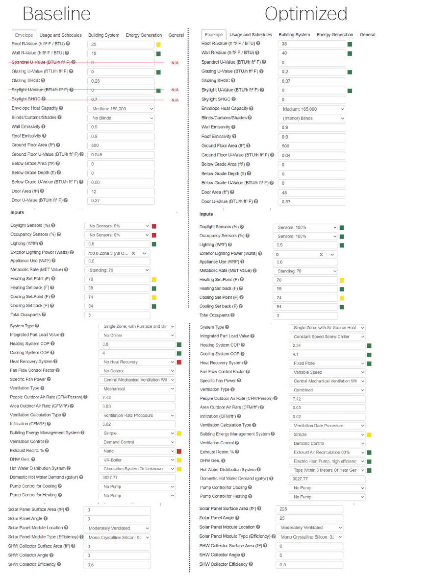

Step 3: Design Refinement and Energy Optimization
After my preliminary design is in a good place, I start to narrow down the details. Here, in particular, since I was focusing on achieving Net Zero, I started to iterate on different building systems, wall and roof R-values, and materials that would benefit better energy efficiency. The main driver with this developed design was to create an overhang over the southern facing windows for passive shading during the summer, while still allowing for heat gain in the winter.
