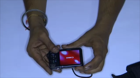

In this project i Used an old canon ixus 130 point & shoot camera which was given by my friend as no longer needed it.

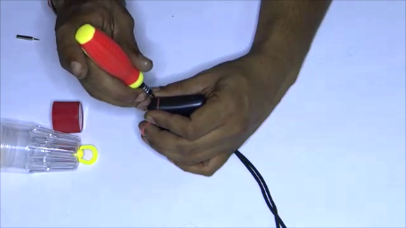

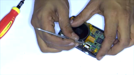

Step 2: Opening the Camera
Carefully open the Outer casing of the camera with a precision screw driver

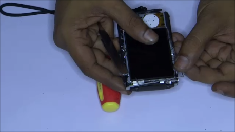

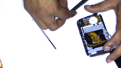

Step 3: Remove the LCD Panel

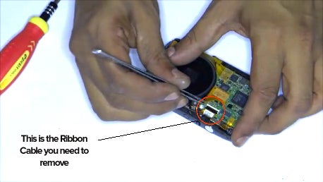

After the casing is removed you need to remove the LCD panel which is attached to a ribbon cable
depending upon the make model the placement might be different however you can always find that on World Wide Web in my camera it was on the front
the ribbon cable is secured with small clip slide the clip on top and cable will come out check the images for reference.

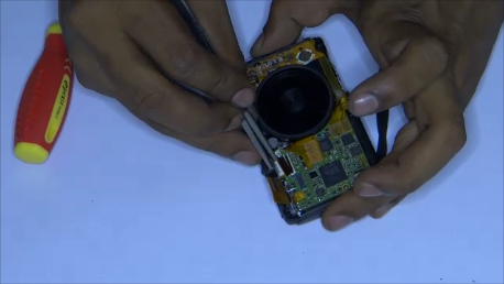

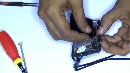

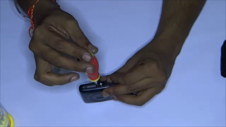

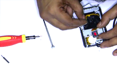

Step 4: Open the Camera Sensor
Once you remove the LCD panel you will see the camera sensor.
BE EXTREMELY CAREFUL WHILE DO THIS ANY DAMAGE TO THE SENSOR & THE CAMERA IS OF NO USE THEN
"IF YOU'RE A MINOR THEN PLEASE DO THIS UNDER ADULT SUPERVISION"
The Sensor i secured with four screws and on each screw there is some glue which can be removed of easily
once you remove the screws you will have to open the sensor.
The colorful glass what you see is the sensor( check the image for reference).

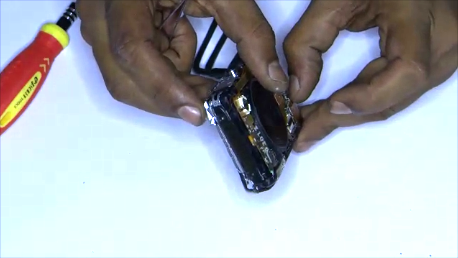

Step 5: Remove the IR FIlter
Film is usually sensitive to visible light too, so an infrared-passing filter is used; this lets infrared (IR) light pass through to the camera, but blocks all or most of the visible light spectrum (the filter thus looks black or deep red).
If we remove the IR filter the camera would be able to see Infrared Spectrum of Light.
So this Small filament what you see is on top of the Camera sensor or on the opening of the shutter
Carefully remove it and keep it aside.
Now place the sensor back and secure it with Screws

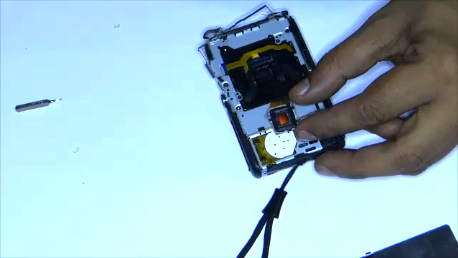

Step 6: Place Everything Back in Place
Once the IR Pass Filter is removed
Secure the sensor back with the screws,
Place the LCD panel back and connect the ribbon cable back
Before putting the outer casing insert the battery and switch on the camera and check it should work

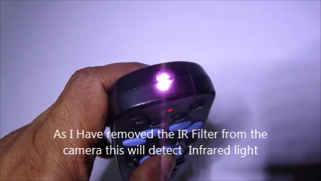

Once its working do a test take your TV remote and press any buttons on the TV remote and you should be able to see the IR led Blinking.

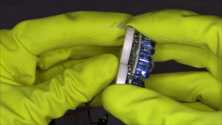

Step 7: Making a IR Led Connection
SO now the IR FIlter is removed we can make a IR Torch for this camera so that we can see in the dark.

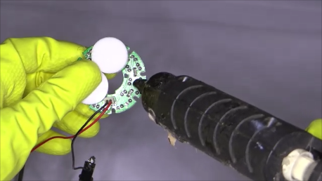

I had a IR led ring from an old CCTV camera which worked well
It works on 12 volts
so I connected it to a 12 volt adapter with a Switch
Usually all the IR Rings have a Light detecting sensor which only works when its dark

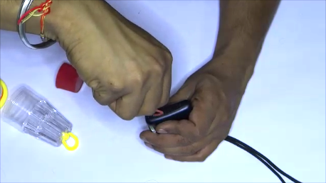

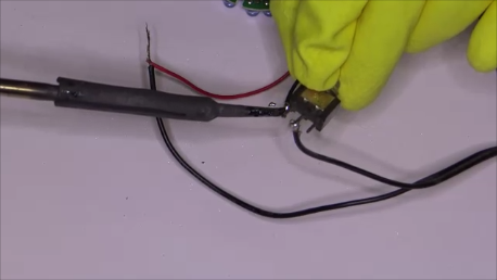

Step 8: Connecting the Led to Power Source
Connect Simple wiring with a Switch and use a DC female pin as a power connecter for the 12 volts.
Solder the wires to the switch and use heat shrink tubing wherever required.

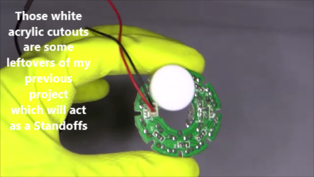

Step 9: Placing the Led
I used some small round acrylic cutouts which were left overs of my previous project this act as a standoff for my
Led ring which I stuck to the camera.

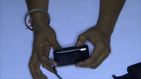

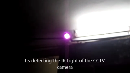

Step 10: Time to Test
Works really well.
The images shown are take in pitch dark with the help of the IR LEDs.
