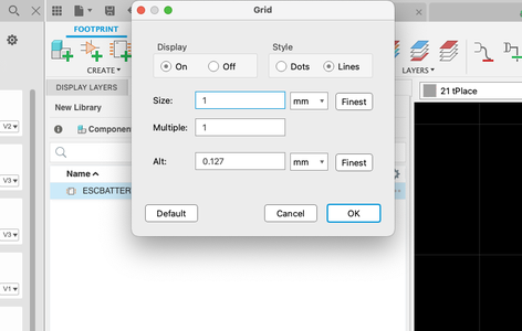

Above View, click on the grid icon and change the size to 1 mm or inch (depending on how you want to measure the sizes of the soldering pads and the spaces between them). Click OK.

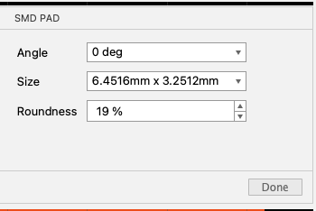

When you click on SMD PAD, a window with the Angle, Size, and Roundness will pop up.
Angle: Changes the orientation of the pad.
Size: You can select one of the provided sizes or double-click to type in a custom size.
Roundness: Rounds the edges. 100% gives you a circle.

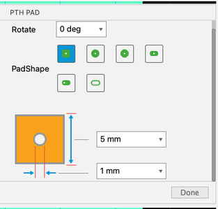

When you click on PTH PAD, a window with the Rotate, PadShape, size of the pad, and size of the hole will pop up.
Rotate: Changes the orientation of the pad.
PadShape: Icons show how the pad will look like. There is a square, circle, octagon, long, offset, and slot.
When you click on the square, circle, octagon, long, or offset, the first measurement is the overall size of the pad.
When you click on the slot option, the first measurement is the width of the pad, while the second measurement is the length of the hole.
The last measurement for all pad options is the width of the hole.
For all measurements, you can select one of the provided sizes or double-click to type in a custom size.

For the ESCBATTERY, I will use the SMD pad.
Click on SMD PAD, and put your values into the pop-up window. With the WINDOW STILL OPEN, click on the grid to place the pad. Once you have placed all pads, click DONE on the window.

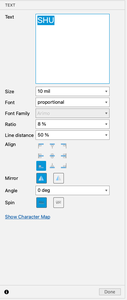

Click on Text or the A icon. A window will pop up with a large text box, size, font, font family, ratio, line distance, align, mirror, angle, and spin. Play around with the settings until you like the look of your text. With the WINDOW STILL OPEN, click on the grid to place the text. Click DONE on the window.

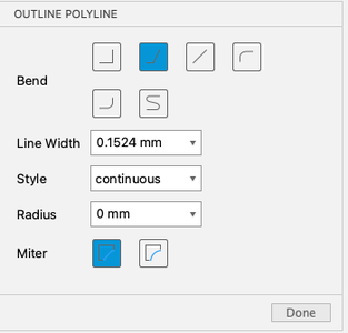

To make a custom shape, click on BOARD. A window will pop up with bend, line width, style, radius, and miter.
Select your preferences and start drawing inside of the previous box. Make sure your drawing is a closed shape or else the design will not work. Click DONE. Delete any lines that are not part of your design. Your final PCB board should have a black inside, and the surrounding outside area should be dark gray.

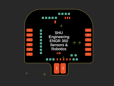

Click on your components and drag them into your board design. Click Save.
To get the files for PCBWay or any other manufacturing company, click MANUFACTORING, which should be below your PCB tab. Click on the third option, Export Gerber, NC Drill, Assembly, and Drawing Outputs. Click OK.
CONGRATULATIONS! You just made a PCB board.
