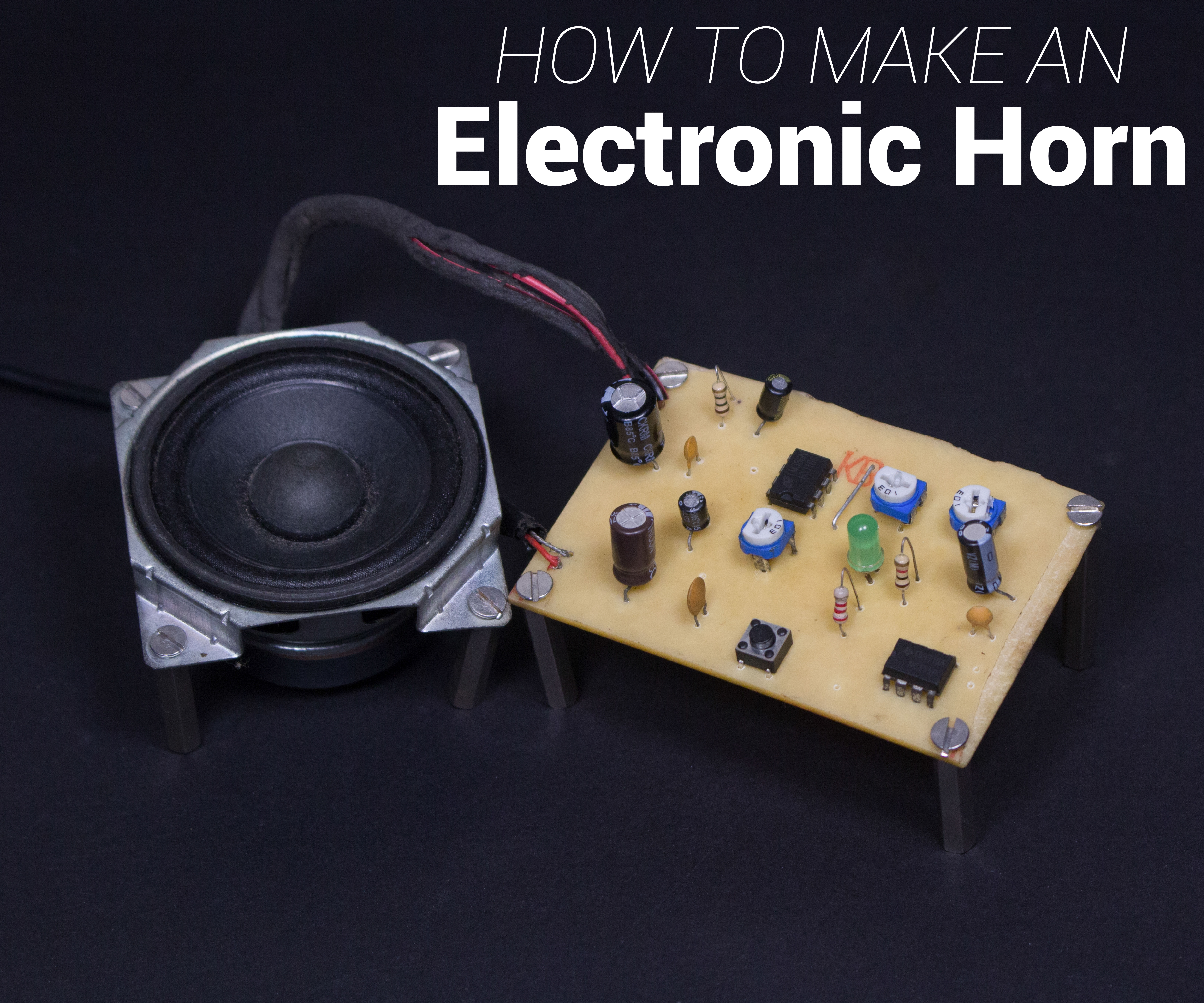

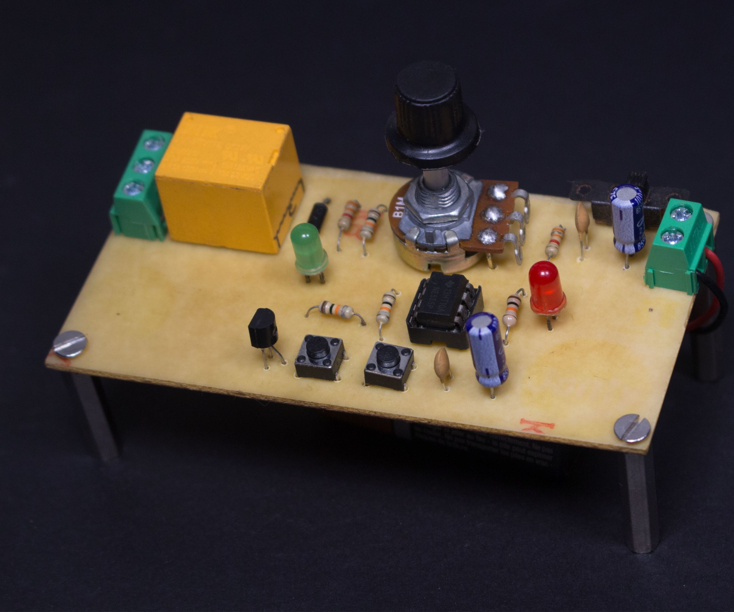

Some of the circuits I have made using this PCB fabrication method.
