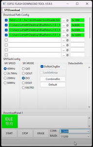

With the adapter connected open the ESP flash tool from the download above.
Set
Chip Type = ESP32
Workmode = Develop
Hit OK
In the software, choose and verify the first three binary files in the initial three fields, aligning them with the options depicted in the screenshot. For the fourth field, also ensure alignment and select the firmware corresponding to your adapter type. The binary offset values for each are as follows: 0x1000, 0x8000, 0xD000, and 0x10000.
Choose the appropriate COM port for your machine. Then, press the START button and wait for the status to transition to FINISH.
Details here @ 8:30

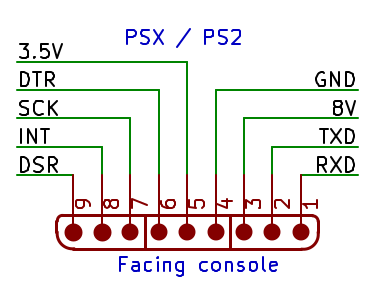

If using a genuine controller, you will need to alter some of the wiring, namely removing pin 5 and replacing pin 3 (8V) with a thicker wire, this is because the BlueRetro draws more current than a stock controller.
Don't worry about the extra current when it comes to your console, as it is still less than using a multitap device anyway, its just the wire is too thin for the ESP32 power requirements.
If you are using a new plug from china, solder 7 wires, the pads on the PCB are named the same as the connections in the diagram. Just match the pin to each pad on the pcb.
