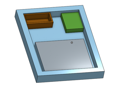

Make sure to also plan out the layout of your painting so you have an idea of what you want the back of the painting to be like. For example, I 3D modeled where I wanted all of the materials to go in the back. The blue shape represents the canvas, the brown represents the cardboard box that will contain the aluminum foil, the green represents the placement of the Arduino, and the gray represents where the rest of the wires and materials will go.
