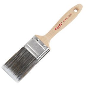

  • An Old Rusty TV Dish
  • Paint Brush

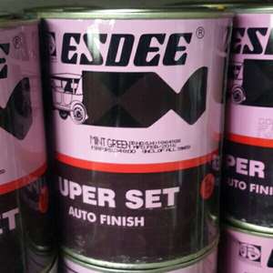

  • ESDEE Super Set AUTO FINISH (or any paint)

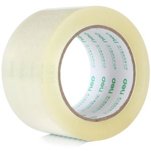

  • Tape
First you need your rusty dish which is our parabolic structure. This structure will collect sound from all around and reflect it to a certain point. You are also going to need a painting brush and a can of paint I am using a metallic finish you can use any paint or you can leave it as it is. The next thing you need is a earphone which have a microphone I took The earphone which came with a phone. You are also going to need some device to record everything I used a phone. You need a piece of foam board for later use. You are going to need some tape you can use any kind of tape I am using transparent tape because it is what I have. Gather these things and start working!.

Make sure that the dish is dried and you can start painting. Open your can of paint and mix it very well and take your paint brush and start painting. You can make your dish any color you want I used an metallic finish because I only had that paint left. Let your paint dry it can take 1 or 2 days. Let's wait for it to dry. We need do some stuff with our receiver unit in the dish. So we can jump into our next step.

Use a piece of foam board to hold the microphone.feed the microphone's audio cable through the hole in the bottom of the unit.If there is a nut then remove it. Take the membrane and place it where you got it. Tape the base and the membrane of the unit. After all of that it should look like the above images. Make sure everything is nice.

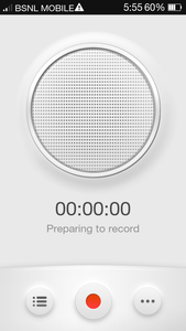

Connect The earphone's pin to your phone . Use The app that came with your phone for recording sound. You can save it and here it. With this you can record what people are saying. Now go Outside and spy on someone!.
