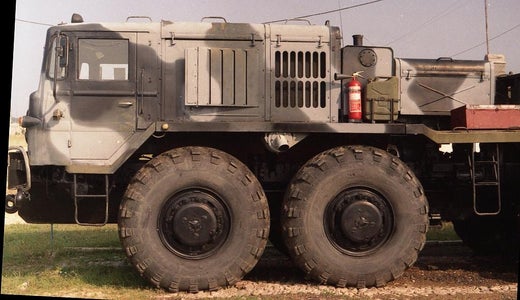

The idea is to put a relatively new MAZ-537G intermediate type with MAZ/chMZAP-5247G Trunmpeter Semitrailer, with a T-34/85 1944 Factory 174 from AFV Club set in the Battle of Berlin and that had just been recovered, the case The thing is that the MAZ came out 15 years after the Second World War, hence it was like a recovery to museum, however I am still not clear about it because of the comments that may come or having to reiterate this same thing several times or too many times.
Anyway, my idea of doing it is because the t34/85 seems to me to be a very emblematic car (and that also came with the interiors and worth detailing (and the Berlin fenders, which I love)), and on the back of this giant I'm sure draws a lot of attention.

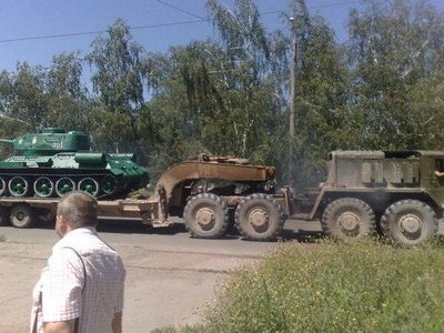

In case anyone believes that this situation is impossible, remind them that a few years ago they recovered a T-34/76 from the bottom of the Don River, which fell there. So why not,
Well this is also presented as a long work table, but not as long as the previous one could be, because simply in plastic pieces, this truck has half as much as the dragon, remember that this was the 25th anniversary commemoration of Tamiya and Trumpeter. see that it was one of many. I have never made any trumpeter or afv club model, so we will see how everything fits together.
Since we have a compilation with the same T34 model, I prefer to start with the trailer (although it is more cumbersome to store while the tank is being built) so that it does not turn out to be too monotonous.
What I have said I leave you with the breakdown.

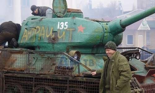

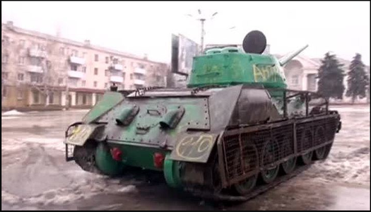

Aun no he empezado con el T34/85 pero quería mostraros el diseño, es bastante reciente, se trata de uno modificado por los prorusos en el conflicto del Donbass. Se ve que lo cogieron de esos que tenían en exposición y ala, a correr.
Tiene bastantes añadidos que hacerle a scratch y si sale bien creo q llamara bastante la atención, mas que el maz, sobre todo por el color chillon.
Solo tengo estas fotos localizadas atreves del amigo google y poco mas, no obstante deberían ser suficientes.
Por si alguien cree que esto es imposible, aqui la foto del mismo conflicto con el amigo maz cargando uno de estos. Quizás si hubiera visto esta foto antes, el maz estaría en otros colores para que se asemejara a este.

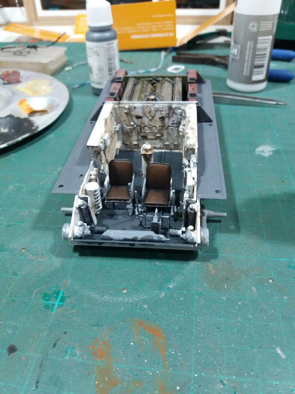

I have the interiors of the t34 ready, the hull area is still missing, but what corresponds to the barge is ready, of this section, step by step I don't have much, except for a couple of photos, it's not that I have much work or anything, but Due to space problems I could not take photos during the process, however I will show you what there is and how it turned out.
The next step is to start changing the engine grilles and add the photo-etched parts, as well as the fenders. Since I have vacations, I hope it won't take too long to finish them and upload them at the end of this week or next week.
As additions here, I have only put a couple of cables that come out of the monitor towards the wall and the compressed air tube, everything else is standard.
Tengo listos los interiores del t34, aun falta la zona del casco, pero lo correspondiente a la barcaza esta listo, de este tramo, paso a paso no tengo mucho, salvo un par de fotos, no es que tenga mucho curro ni nada, pero por problemas de espacio no pude estar sacando fotos durante el proceso, no obstante os muestro lo que hay y como a quedado.
El siguiente paso es ya ponerme a cambiarle las rejillas del motor y añadir los fotograbados, asi como los guardabarros, como tengo vacaciones, espero no tardar demasiado en acabarlos y subirlos a finales de esta o la semana que viene.
Como añadidos aqui, solo he puesto un par de cables que salen del monitor hacia la pared y el tubo del aire comprimido, todo lo demas, es de serie.
