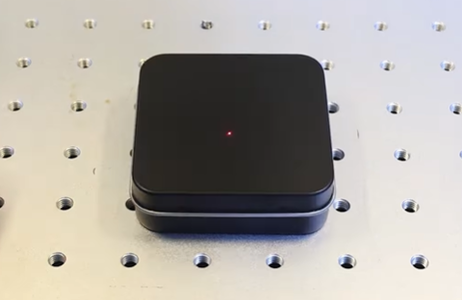

Step 1: Place the Candy Box
Put the candy box on the laser bed. Since it is flat in the center, the candy box will be well suited for laser marking.

Step 3: Don't Miss the Focus
Missing the focus is one of the biggest reasons for laser marking failure. So don’t forget to click the AF button for auto focus.
Of course, manual focus is also effective. Hang the focal stick at the correct position under the lens, and then carefully adjust the Z-axis height. When the end of the focal stick just touches the surface of the candy box, it is in focus!
Red light focus
Auto focus

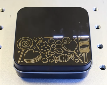

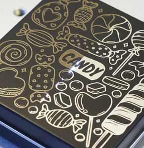

Once laser marking is complete, carefully open the door and get your personalized candy box. Laser marking does not produce toxic substances, and you can use the candy box after a simple cleaning!z
Step 6: Complete the Laser Marking
Laser marking candy box is a stylish and practical way to keep your essentials organized. With laser marking, you can add a personal touch—whether it’s your name, a logo, or a custom design—making it truly one of a kind. Perfect for work, travel, or as a thoughtful gift, the laser candy box is a simple yet classy everyday accessory!
