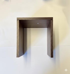

In this step, you are going to gather your three pieces of wood that are 6" by 6". After gathering your wood, you are going to start to attach your pieces. In the second photograph, I show how the pieces are going to stand upright. Next, you should pre-drill your holes so it is easier for the screws 1/2 " (x4) to be put in. To do this, you need to line up the center of the edge with the center of the edge on the top piece. The thickness of his wood is 3/4", so the center of it would be 3/8". The holes were 4" apart with 1" from the end of the wood. The third photograph is with that third piece of wood attached to the other two. Finally, the last three photographs show what it is going to look like after it is all attached. I found it easier to have another person help me during this step.

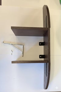

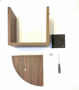

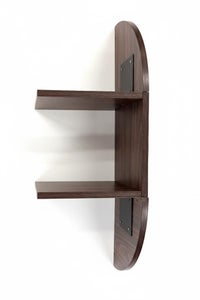

In the first photograph, I show you the bracket, wood piece, screws 1/4 " (x4 on each bracket), and the base (which we put together in the first step). With the holes pre-drilled, I attached the metal bracket to the wing (1/4 circle of wood). This is going to be our support to hold the sides in place. Once the bracket is attached to the wood, it is time to attach it to our base. After one side is complete, repeat this on the opposite side. The second and third photographs show the complete look just from different angles.

Next, I attached the plant hook to the front of the base with x2 1/4" screws. The second and third photographs show the final project. This step can be avoided, but I thought it would be a fun touch!
