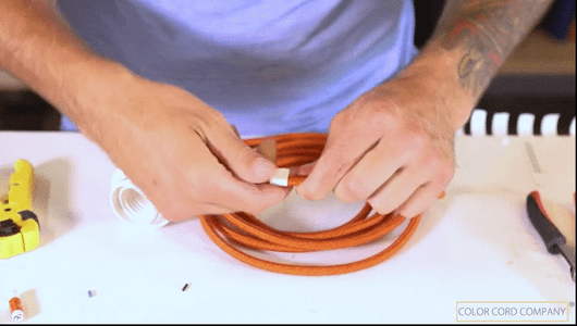

Step 2: Wire a Cord Plug-End
- Remove the screw from the top of the plug.
- Pull-on the prongs of the plug to release the plug from the shell.
- Insert the same end of the cord into the plug shellʼs small opening.
- On that same cord end, measure 11/4 “ from the tip of the cloth-covered wire, and wrap an inch of electric tape over the wire.

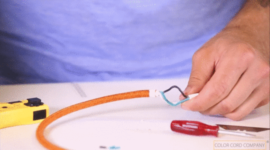

- Over the midsection of the tape, strip the PVC housing to expose the 3 conductor wires.
- We recommend the use of our Color Cord 3000 striping tool.
- Make sure that there are no cuts on the conductor wires exposing the internal stranded copper wire.
- Using your fingers, twist the stranded wires together.
- Locate the positive (brass), negative (silver) and ground (green) terminals on the back of the plug.
- Loosen the 3 screws on the back of the plug to open the terminals.
- Wrap the stranded copper wires on each matching terminal screw.
- The black wire (+) with the positive terminal, white wire (-) with the negative terminal and green wire with the ground terminal.
- The stranded copper wire should be tucked in the terminal, covered by the screwʼs head. Tighten the screws of each terminal to secure the wire in place.
- Pull the wires to make sure the wires wonʼt pull out of the terminals.
