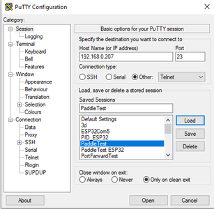

Use the serial monitor to find the IP address of your Paddle when it starts up:
Welcome to Oculus Paddle Net
Connecting to WiFi............
WiFi Connected. IP: 192.168.0.207
Starting IP Broadcast.
Once you know the IP address assigned to your paddle you can use Putty to connect .
You should constant output on the terminal - the parameters should change as you turn the paddle / press the buttons.
{140,1,1,1}
{140,1,1,1}
{140,1,1,1}
{140,1,1,1}
{140,1,1,1}
