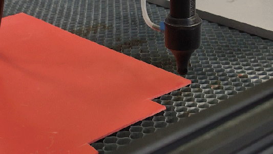

I know rubber is best engraved with blowing. Therefore, air is supplied to the nozzle. First, so that rubber smoke does not get on the lens. Secondly, it will blow off the burnt-out rubber.
When engraving e rubber of it stands a lot of smoke, so the job will be to make a system of ventilation in the box.
The photo also shows a CO 2 tube and an air compressor for blowing off.
Step 2:
First you need to determine the speed and power parameters for engraving.
After 20 attempts, I finally found this ideal regimen. The best result for me was obtained with a line frequency of 0.04 mm and a power of 60% of a speed of 1700 mm / min .

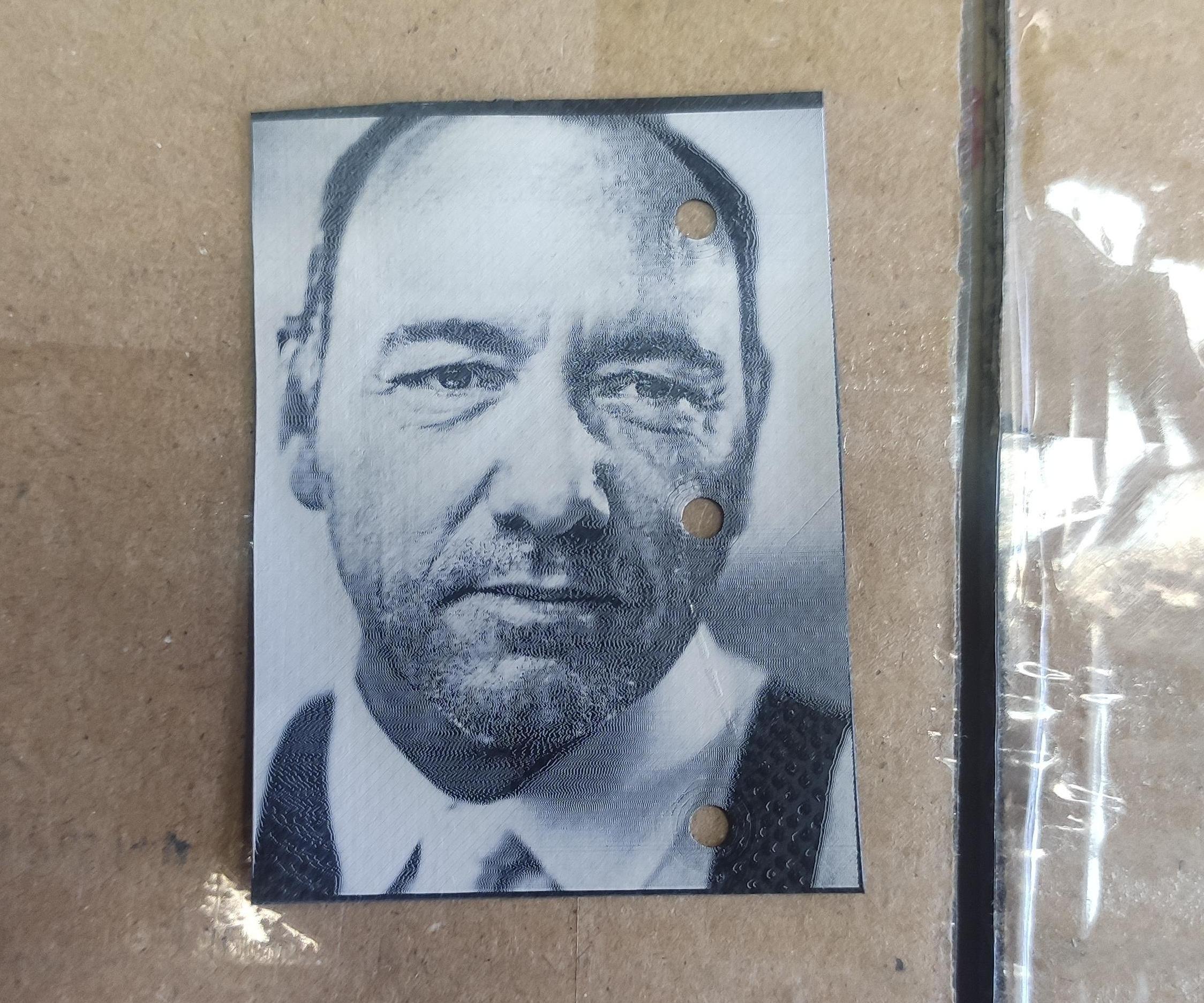

During the engraving, I realized that I forgot to mirror the print, because of this, a mirror trace would remain on the paper. Here's what happened after the engraving.
When I took out the rubber from under the nozzle, I realized that I forgot to make a layer for cutting the print, so I cut it out with scissors. I didn't do it very well) . I tried to set it in the same position and start cutting to trim the edge. But, as expected, exactly this did not work, so I start all over again (((
Step 5:
The second time I did everything right and set all the modes correctly. Here is the final result.
