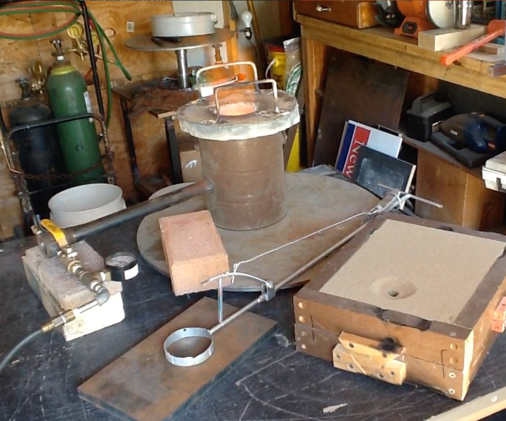

How To Make A Propane Forge Burner For Your Blacksmith or Knife Making Forge. The Burner Can Easily Be Made For About $15.00 Using Readily Available Supplies From Your Local Hardware Stores. This Type Of Burner Can Also Be Used For An Aluminum Melting Foundry Furnace. A Complete Overview of How I Made Mine. Thanks For Watching!
