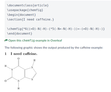

  3. It work really well (as one could guess) for science diagram: you can make cool chemical formulas if you want to as shown in the illustration of cafeine (from overleaf website).
