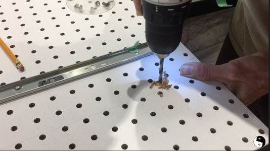

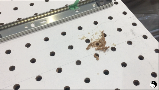

Use a drill bit that will allow the Chicago screws to fit snuggly through the metal (and pegboard). Drill at least 3 holes along the length of the metal. This is where your stud wall measurements come into play; use them to determine where to drill. After drilling holes in the metal, transfer those marks onto the pegboard. Then drill through the pegboard in those spots.
As you can see in the last pic, the holes will be smaller than the original pegboard holes to accommodate the width of the Chicago screw.
