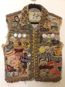

Punk patches are exactly what they sound like, its a patch of fabric that is often used to cover up holes in clothing. However punk took this a step further and turned patches into a fashion statement. Punks painted over their patches with political statements, band logos, and shocking imagery and the punk patch has since become one of the most recognizable pieces of punk fashion. Eventually, they stopped using these patches to just fix clothes and instead use them almost purely for patches.
This (along with a lot of other factors) led to the creation of the battle jacket. A battle jacket is a jacket that is covered in patches, most often these are band or political patches but the term battle jacket has become a lot more inclusive to include all kinds of patch jacket (patch jacket is another term for battle jacket). Above I have included pictures of what a lot of battle jackets tend to look like, they tend to be rugged, grungy, clearly handmade, and often smell bad (your not suppose to wash your battle jacket, I'll talk more about that later.)

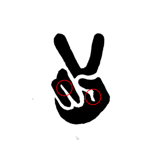

After you have printed your stencil, we move on to the fun stuff: KNIVES.
Use your X-acto knife or box cutter to remove all of the black parts of your stencil. The best way to do this is with a piece of wood or old hardcover book behind it, but sometimes I just do on my concrete floors (although this does dull the blade very fast.)
When you are cutting out the pieces be VERY CAREFUL about the thin white strips (highlighted above), if these rip, it makes the next step much harder to do.
After that, you should have an image that looks similar to what is above. Ignore the thick black lines, those are just from the screen shot I too and are unimportant. Additionally, I should have made it a little bigger, but it is what it is.
NOTE: Start with a sharp blade when doing this, If you do this with a dull blade the paper pills up and won't cut out as nice, leading to a messy stencil and a messy paint job.
