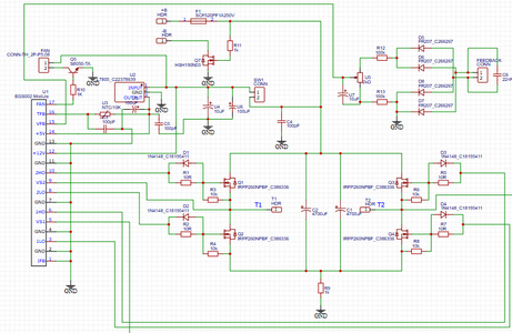

Step 3: Circuit Diagram
Discover Easy, Affordable, and Reliable PCB manufacturing with JLCPCB!Register to get $70 New customer coupons:https://jlcpcb.com/?from=EST
Special Deal: Get a $30 coupon for JLCPCB premium 6-layer PCBs: https://jlcpcb.com/6-layer-pcb?from=getcoupon
The inverter uses an EGS002 module, four MOSFETs (IRF3205 or IRFZ44N), a UPS Transformer, a 12V or 24V battery, and supporting components. The circuit connects these together to produce a stable AC output.
Circuit Diagram Explanation (Serial by Serial):
  1. The EGS002 module is at the heart of the design. Its SPWM outputs (H0 and L0) drive the gates of four MOSFETs arranged in an H-Bridge configuration.
  2. The H-Bridge alternately applies the 12V or 24V supply across the primary winding of the UPS Transformer, creating a sine wave voltage at its output.
  3. The feedback circuit (using diodes and resistors) connects the output voltage back to the EGS002 module, allowing it to adjust its PWM and maintain a stable output voltage.
  4. The fan transistor (Q5) is driven by the EGS002 module. It turns ON the cooling fan when needed (according to the module’s thermal and load monitoring).
  5. The filter capacitor (C1) across the supply lines smoothens the DC supply. The smaller capacitors (C4, C5, C6) reduce noise and stabilize the module.
  6. The MOSFET gate resistors (R1–R8) limit the gate charging and discharging currents, providing better switching characteristics and longer MOSFET life.
  7. The F1 fuse provides overcurrent protection for the circuit.
  8. The LM7805 regulator provides a stable +5V supply for the EGS002 module.
Step 4: Pin Connections of the EGS002
Here’s how you connect the EGS002 in this design:
  1. Pin 1 & 2 (GND): Ground connections.
  2. Pin 3 (IFB): Current feedback from the output to regulate load and maintain stable voltage.
  3. Pin 5 (L0): Low Side Gate Drive for MOSFETs.
  4. Pin 7 (H0): High Side Gate Drive for MOSFETs.
  5. Pin 9 & 10 (VS1, VS2): Voltage sense inputs for output voltage feedback.
  6. Pin 17 (FAN): Output for controlling the cooling fan.
  7. Additional Connections: The EGS002 requires a +5V and +12V supply for internal logic and gate driving.
