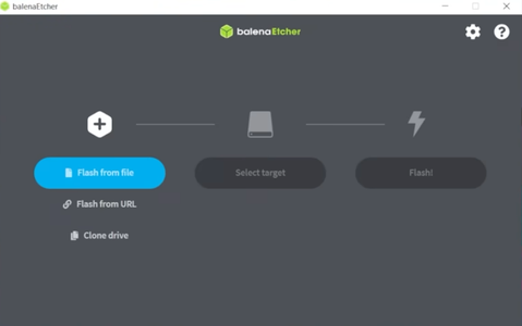

Step 4: Flash the Image
download balena etcher here: https://etcher.balena.io/
next, download the file here by clicking code, the download zip: https://github.com/evilsocket/pwnagotchi
extract the zip file, then open balena etcher and select flash from file
open the image file
select your storage and click flash

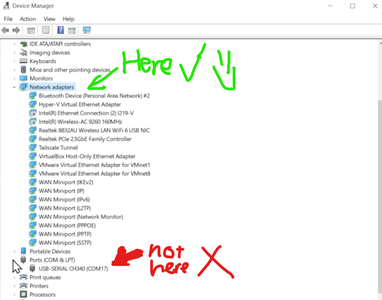

now go and open device manager on your pc
it should show up as a network adapter, if it doesnt, you have an extra step :( (top right)

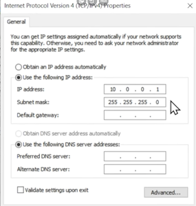

if you do have it then go to your ethernet settings, then click "change adapter options" on the right. :D
you should have a new ethernet device you dont recognize(bottom left) it should say RNDIS gadget.
right click on that and click properties. scroll down until you see internet protocol version 4 and click properties

right click on that and click properties. scroll down until you see internet protocol version 4 and click properties, yours should look like the one shown above. if it doesnt, make it.

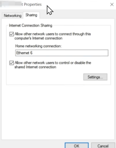

close out of that and go to your ethernet or wifi, click properties, then sharing.
you want to make sure that it is sharing with your pwnagotchi (ethernet 6 in this case)

Step 7: Extra Step :(
dont worry, its not hard. you just have to download a driver here: https://modclouddownloadprod.blob.cor...
then unzip it and click on the RNDIS.inf file

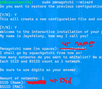

type sudo pwnagotchi --wizard
then say no to restoring a previous config, as there is none
then yes to making a new file
now you get to name your pwnagotchi :D
its going to ask if you want to whitelist your network, if you want to attack your own network then skip this, but if you don't, then say 1 (if you have more than one then type that number) then type in the name of your network.
say no to BT tether
say yes to a display, if you've got the waveshare, say waveshare_4, if you don't know what display you have then click the link.
now choose if you want your pwnagotchi to be black or white
config is done!
