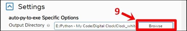

Step 8: To Choose Where Your Executable Program/file (.exe) Is Made
Under "Settinngs"
> "auto-py-to-exe Specific Operations"
> "Output Directory"
> click "Browse" and select your desired location
