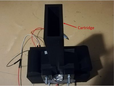

Step 1: 3D Print the Structural Parts
The photos above show how the 3D printed parts look. I have attached the .stl files below and also the Fusion 360 archive file. Do NOT print 'batteryTester v10' stl file, which is only meant to show you how the 4 components fit together. Thus print box, cartridge, sliderV2 and support.stl files.
If the components are orientated correctly in the slicing software, very little support material and clean up will be needed for the 3D printing.
Step 2: Bolt Together the Structure
Bolt together the support and box component. The bolt holes do NOT have threads, so tighten the nut and bolt to establish the strong joint. The slider will move independently from other components and thus will not be bolted and the cartridge will be bolted at a later step.

Step 5: Attach Aluminium Onto Structure
Tape what you made in Step 4 to the structure as shown in the photos above. Remember the duct tape is needed to reinforce the weak solder joint.

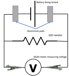

Step 6: Solder the Veroboard
The resistor, pair of alligator clips and pair of aluminum pads are connected in parallel on the veroboard (see diagram above). For the aluminium pads, the plug-to-socket jumper wire is soldered onto the veroboard, so you can plug this wire onto the wire you soldered onto the aluminium pads in Step 4. The alligator clips will be used in Step 9 to connect the circuit to multi-meter.
This is a voltage measuring circuit, since this voltage can indicate the remaining the capacity in the battery (see the PDF files attached below). In the PDFs, the service hour to voltage charts show that the battery voltage only drops below 1.2 volts towards the end of the service hours. Thus, I defined the threshold for a good battery as one that output 1.2 volts or more. Please note, 1.2 volts is a good threshold for rechargeable batteries, not necessarily for non-rechargeable ones; you can define the threshold voltage to your needs.
The 10Ω resistor is necessary for accuracy. Without the resistor, the total resistance of the circuit is that of the multi-meter, which is about 10MΩ since it is measuring voltage. Remember the threshold voltage is only 1.2 volts. Thus, you only need 1.2 volts / 10 million ohms = 120nA of current, which is not enough the power any typical household appliances. Thus, without the 10Ω resistor, the circuit is testing if the battery can send nano-ampere of current instead of can realistically power appliances. The 10Ω resistor serves to reduce the total resistance of the circuit, allowing a more representative current flow during the test.
Resistor selection:
Since the resistor has significantly less resistance than the multi-meter, the total resistance is approximately equal that of the resistor. At 1.2 volts, the 10Ω resistor allows a current of 1.2 / 10 = 120mA, which is representative of the currents used in household appliances. A resistor greater than 20Ω allows too little current. Also, a resistor less than 5Ω is too sensitive the resistance in the aluminium pads, unintentionally creating a voltage divider and thus inaccurate readings, since the aluminium's resistance is becoming comparable (so not negligible) to that of the resistor.

Step 8: Bolt on the Cartridge
Two bolts are used.
