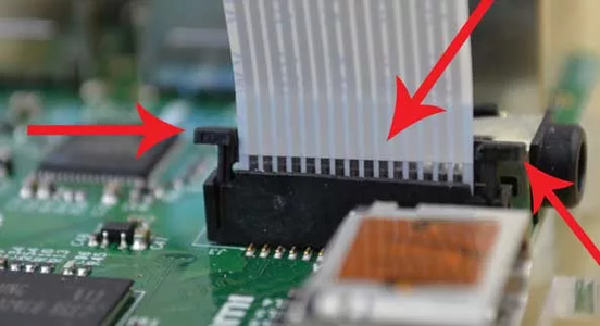

Second, we will need to install the camera. To do this, go to the ribbon slot and using two fingers to pull up on both sides of the connector gently.
Now the connector is open. Insert the ribbon cable with the metal leads facing away from the Ethernet port. Make sure it's lined up, then gently press down on the connector. The cable should be locked in place, and we can now move on to the software.
On a side note, if you want to install this into a more secure enclosure, you can buy some great equipment or even design to do this. However, to keep this tutorial pretty basic, I will not go into a heavily customized camera enclosure.

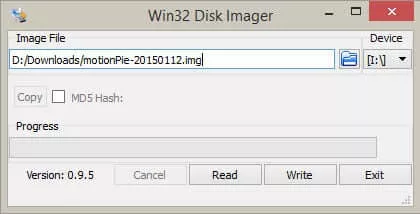

1. Download the Win32DiskImager.
2. Now, unzip the MotionEye OS img file so you can install it onto the Pi safely.
3. Select the MotionEye OS img file and the drive letter your SD card is assigned (Eg. G:/)
4. Confirm you have the correct details and click on Write.
5. Once done, you can safely remove your SD card from the computer.
