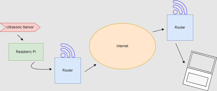

The goal of this project is to get some information from a sensor, then display it to a website over the internet. Also, remember that the Raspberry Pi isn't as powerful as big servers which may mean that it probably won't be able to handle as many requests, but remember that this is running on Linux, so you can do the about the same thing on any other machine with a Linux OS, with probably better hardware. But just the fact that this can be one while some people and companies use ones that cost hundreds and sometimes thousands of dollars is just fascinating!

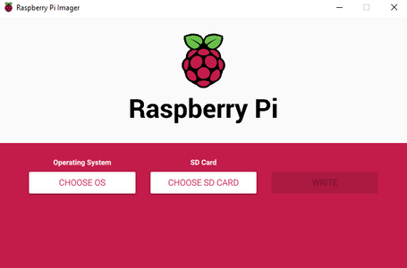

Step 1: Baking the SD Card
If you are going to use Raspberry Pi OS Lite, start out by installing the Raspberry Pi Imager on the Raspberry Pi website. Once you've done that, open the application and insert your MicroSD card into your computer. For the OS option, click Raspberry Pi OS(Other) and then click the Lite version. For storage, be sure to choose the proper card. Just know that everything on it will be erased, so be sure to triple check it. After that, press Ctrl-Shift-X. This will bring up a "secret menu" to enable some "secret" settings. What we'll want to do is enable SSH by checking it and choose a password of your choice. As always, choose a secure password. Then scroll and click "enable Wi-Fi", enter the Wi-Fi name in the SSID blank and then your Wi-Fi password. Now click on save, make sure everything is right, and write to the card.
Once that's done, log into your router and check for devices connected to it. If you went for the default hostname, it should be called "raspberrypi" and it should have an IP address next to it. What you'll now want to do is hop onto another computer, and enter this command into the terminal:
ssh pi@[IP address of the Pi in your router]
Now, you're in the terminal remotely and ready to start!

Step 6: Port Forwarding
If you tried accessing the website, it probably didn't work. That's because you need to forward some ports. But wait, what is that? Well, to be able to access it from the internet, you need to be able to make it visible to others first. And that's what port forwarding is. The router creates a route between the public network and your own one.
Alright, so how do you do that? Well, you'll have to be able to log into your router to access the settings. You'll now have to find the setting for enabling port forwarding. Add an entry for the Raspberry Pi that opens port 80 to 443(That's what I used). You can find more info online on how to do this on your own router.
