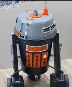

Step 1: Choose Your Droid Shape
The first step is to find all the materials you are going to use and design the shape of your droid, there is a lot of images in the internet that serve as inspiration, based on them you can cut, drill and put some details in it.

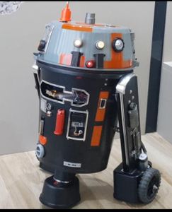

Step 2: Internal Structure
Now that you already have it's body, its time to organize the interior structure! The battery is the heavier component in the droid, so it needs to be in the botton of the body.
The whole eletronic system is placed in a platform fixed around a PVC pipe that will eventually serve as a bearing to the spinning dome.
The droid is controlled with bluethoot signals sent from a cellphone, the bluethoot module receives the signal and send it to the Arduino Mega that will run the uploaded program and send a command to other module, depending on the program decision, it could be the H bridge module that control the motors, or the SD card reader that run the audio flles, responsable for the Astromech noises, or it could turn on a simple LED.
The top of its body is covered with a circular wooden board with a perforation on its center, where the PVC pipe will be fixed. On the edge of this board there is a 3V motor with gearbox, connected to a wheel that will make contact with the internal part of the dome(head) and make it spin around its own center. In order to hold the dome in its place and simultaneously make it spin, a smaller PVC pipe is fixed in the middle of the dome, and it will go in the other pipe fixed in the body. Now you have a rotary axis for the dome.
Step 3: The Legs and Motors
One of the most iconic characteristics of an Astromech Droid is their 3 legs, the two bigger legs carry the 12v Power Window Motors, responsable to make it walk. This legs are made out of two thick rectangular shapped wooden boards, that you will cut and fix with an angle that fits in your Astromech size, the motors are positioned in the extremity of the leg, with two shopping cart wheels attached to the motor with screws and Titanium Glue.
The third leg is a big silicone wheel, fixed under the body, and it is very important to the droid balance.
All these wheels can be covered with recycled ice cream boxes, to simulate the Astromech feet.

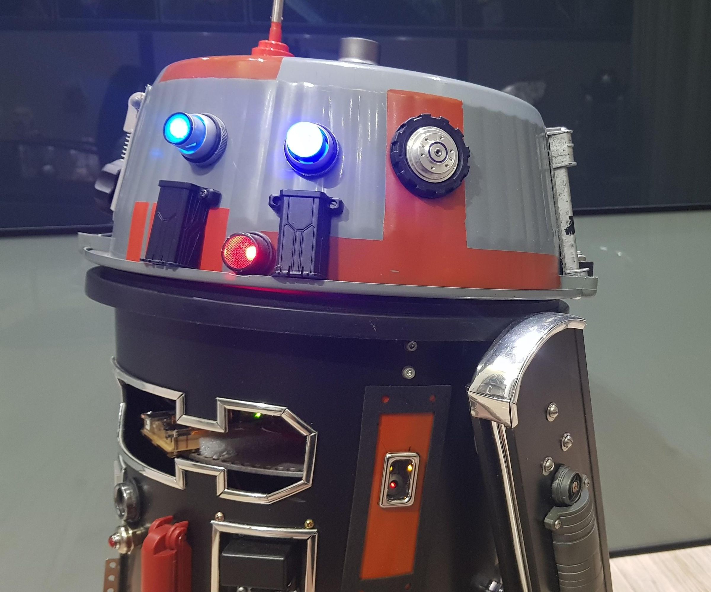

Step 5: Final Details
Once the structure and eletronic systems are finished you can add the final details and customize your droid as you want using every recycled greeblies you can find, adding a paint job, weathering, and a several LEDs, giving them a unique personality. Don't forget to check out the result in my Youtube Channel where you can find the two episodes of this awesome build!
