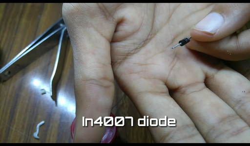

6) in 4007 diode

Connect usb wire to led indicator through a 10 ohm resistor then take a 1n 4007 diode and connect to positive wire of usb then connect both positive and negative wire to the battery next step is connecte battery positive to switch and battery negative to a 1ohm resistor then connect that to wire to led panel. Wiring is finished.Take a plastic sheet glued to the top of the box and glied the led panel to the top of the sheet
