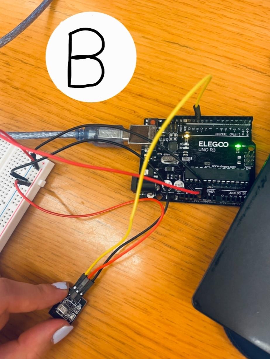

B. Connect the IR receiver module
  1. Check your IR receiver's datasheet for which pin on the receiver is power, ground, and signal.
  2. Use female-to-male wires to connect power (red wire) to the positive power rail, and ground (black wire) to the negative power rail.
  3. Connect signal (yellow wire) to a digital pin on the Arduino, I used 11.

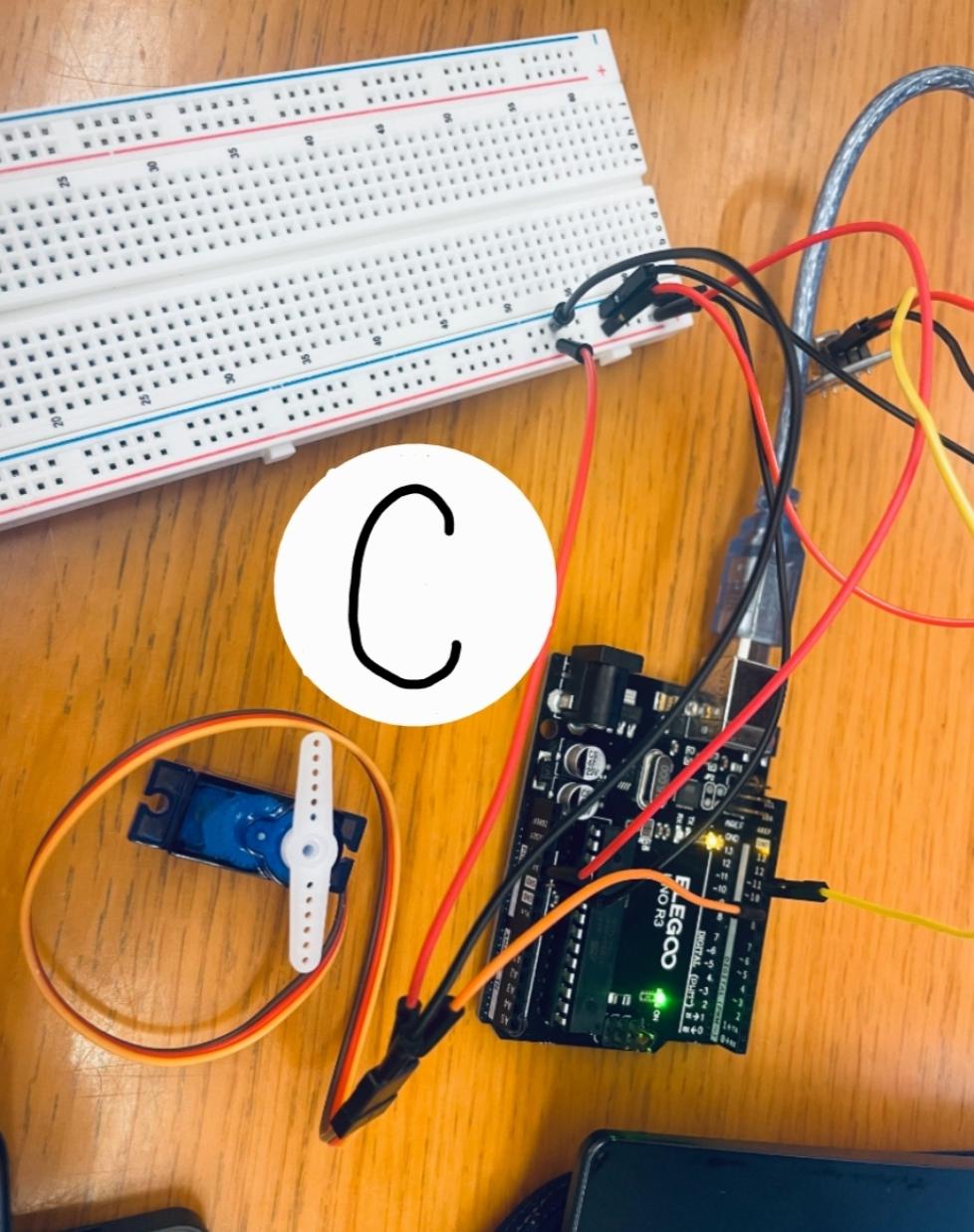

C. Connect the servo motor
  1. Check your servo motor's datasheet for which connection on the motor is power, ground, and signal.
  2. Use breadboard jumper wires to connect power (red wire) to the positive power rail, and ground (black wire) to the negative power rail.
  3. Connect signal (orange wire) to a digital pin on the Arduino, I used 9.

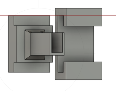

Step 3: 3D Print and Assemble the Mount
Print the STL file linked in 'Supplies' titled CatToy_Mount.stl. There are two individual pieces that interlock with each other and the servo. I was looking for a design that could withstand the torque of a cat pulling on the toy, and was inspired by interlocking T-rails often used to mount heavy shelves. I printed the piece at 100% fill to maximize its sturdiness.
Wait for your piece to fully cool, then you can interlock the pieces and attach the servo, they should fit snugly.

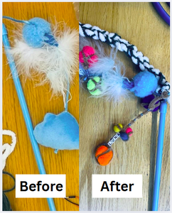

Step 4: Customize Your Toy
This step is optional if you just want to attach a cat toy you already own, or you can get crafty and add to your existing cat toy with items lying around your home.
I used pipe cleaners to string colorful pom poms together with some beads. Simply wrap the pipe cleaner in a cross around the pom pom, securing the end in a twist with itself. I had letter beads, so I wrote my cat's name.
With some yarn of varying color, thickness, and texture, I created a nine-strand braid by making three braids, then braiding the braids together. My cat loves it.
If you have small bells with loop attachments, you can string them together for an added audio feature.
