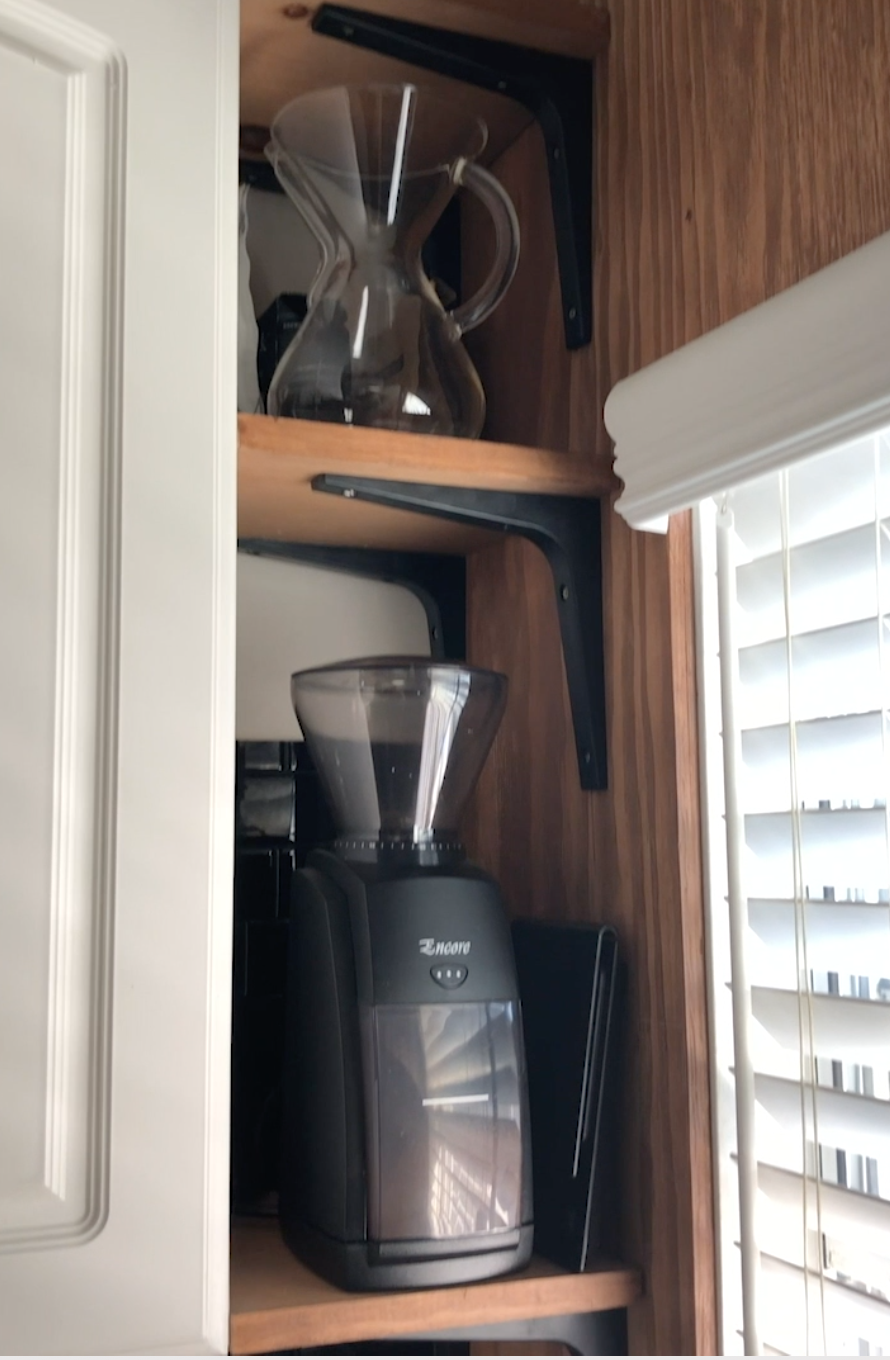

Step 8: Installing Shelves
The left side needed something to hold it in place, but here instead of using a tension rod, I went with shelves that wedge perfectly in the gap between the cabinets and the wall. This makes use of this otherwise wasted space while at the same time securing the wall.
Step 9: Wall Is Ready to Vertical Storage
The shelves are now a coffee station (the height of the shelves makes it possible to use the coffee grinder without taking it off the shelf, very useful when you have very little counter space!). I installed a rack and small shelves on the other side to add more storage for cookware, all without making any holes in the actual wall behind the plywood. I also used the tension rod to hang baskets for fruit and veggie storage, again freeing up that precious counter space.
