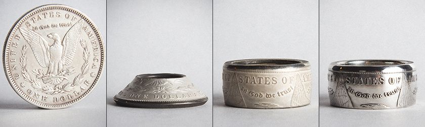

There are two types of rings made from coins. One is where you punch out a large hole in the middle of the coin, and then proceed to start turning the coin inside out, such that the faces of the coin become the top and bottom of the ring band. This method required more specialty tools. I will be showing you the alternative method, where you hammer the coin along the edges to make a ring out of the edges, and then remove the center.

Place the coin edge down onto your metal surface. I used the base of a table vice. For this step, you will slowly roll the coin while tapping it with a hammer. Don't hit it too hard. Take your time on this part, as you want the coin to form uniformly. After a dozen or so taps, I like to flip the coin around to keep the edges from favoring one side too much. As you progress, the edge of the ring will become wider and wider, and the diameter will become smaller and smaller.
You will want to periodically check the size of your coin ring using a ring you have that you know fits you. This is to make sure we make a ring that is the correct size. Once the coin ring's diameter is the same as a different ring that fits you, you will want to stop hammering and move on to the next step.

Lastly, we need to remove the remaining metal from the inside of the ring. To do this, grab the ring in a table vice as shown above. Here you will want to push a circular file back and forth, slowly removing the interior of the coin. Be careful once you get close to the edges. The inside of the edge will contain the text from the edge of the coin, and you will want to preserve that. To be clear, the text will have wrapped around to the inside band of the ring, and is no longer on the face of the coin. Thus you don't need to leave very much material in the ring to preserve the text. Once you get really close to the edge check the coin after each swipe with the file. Once you start hitting the top of the lettering, stop filing on that side.
Once all the interior of the coin is filed out, your ring is done! You can also polish the inside with tooth paste or polish, but the inside will also become very smooth from use if you wear the ring alot. My ring has been worn for 3 years now and the inside has worn to be very smooth, but the lettering has remained legible. You may also need to hand polish a section of the ring or so if it got scratched in your vice or by the file by accident. You can also use a dremel with a drum attachment to smoothen out the interior of the ring.
