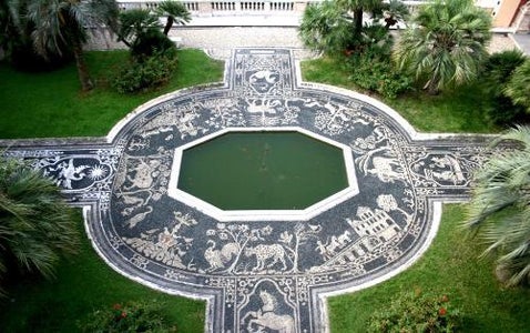

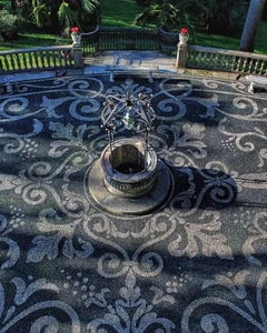

It is a typical technique of my region of origin, Liguria, and has been widely used in the architecture of the noble villas of Genoa since the year 1500 and derives from the best known, and most valuable, roman mosaic technique.

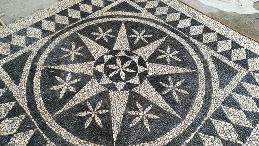

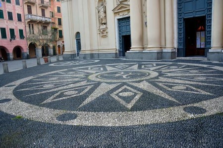

The rissêu is a path, square, churchyards or, more generally, a cobbled outdoor space; rissêu is in fact a term in the Genoese dialect to define the pebble.
The pebbles are chosen for their color and size (3-5 cm) on the beaches of the rivers or the sea or in the quarries. Pebbles of black color (serpentinite), white (quartz or calcite) or more rarely reddish (jasper). The laying work is painstaking and about 3 million pebbles are needed to make the square of a church.
