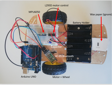

You do NOT need the exact same hardware, if you can understand and adapt my code. The information in the brackets are the exact hardware I used. I have attached datasheets below for further information.
  1. Laptop with Arduino IDE installed
  2. Arduino board (Arduino UNO)
  3. MPU6050 Triple Axis Accelerometer and Gyro module
  4. 7 - 12V DC power supply (6X AA rechargeable batteries)
  5. motor control module (L293D)
  6. wireless communication e.g. radio, Bluetooth, infrared (HC-05*)
  7. two motors and wheels (TT motors)
  8. Structural element for the chassis the car
  9. A 100 to 500uF capacitor to stabilize the 5V output of Arduino
  10. Breadboard + jumper wires OR soldering + PCB

Step 1: Overview
The circuit diagram above visualizes the pin connections in my code. Into the serial monitor while running the code, enter characters, a, w, d to move the car; i for print out of information; p for pause. Remote control commands are entered into the serial monitor. When using the serial monitor, the wireless HC-05 replaces a wired USB cable, so the command is sent from serial monitor on computer, to Bluetooth connection of HC-05, then to TX and RX pin on the Arduino using USART serial connection.
My solution uses software and some control engineering concepts to correct the hardware imperfection of the motor that prevents the robot car from driving straight. The software corrects it by giving less power to the stronger motor. For me, the stronger motor is the left one. If your right one is stronger, you need to modify the driving () and controlSpeed () functions in the Arduino code (attached below Introduction section).
When gyroscope detects the car is veering too much to the left, it increases power to the left motor (since now left motor outpaces right motor to make the car turn right). When veering too much to the right, it reduces the power to the left motor. The MPU6050 gyroscope detects if the car is veering left/right and by how much. Based on this detection, Proportional Control Technique adjusts the power to the left motor.
The Arduino controls the power to motor via the motor control module (L293D) and its PWM (pulse width modulation) pins. These are pins are represented by leftSpeed and rightSpeed constants in the code. Note: not all digital pins on Arduino are PWM. PWM is basically a square wave turning on and off at high frequency, this causes the average voltage at the PWM to pin to be lower than if it is constantly on. The motor control module interprets this lower voltage and reduces power to motor accordingly.
