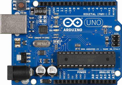

1.Arduino UNO board

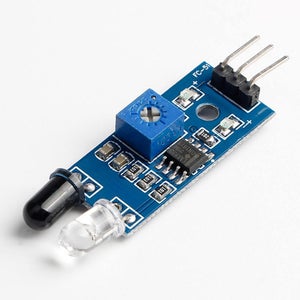

2.Infrared module x2

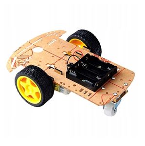

3.Car kit Arduino

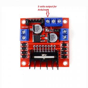

4.LM298n DC Motor dual bridge

Step 2: Construction and Wiring
In this step we assemble the kit, mount the Arduino board on the chassis and make the connection according to the electrical scheme.
