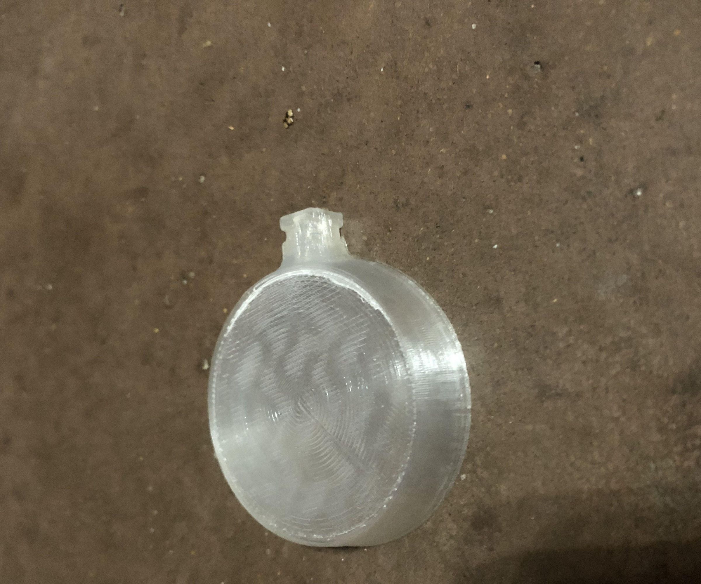

Step 1: Printing the Segments
In order to print the segments make sure you have dialed in setting for obtaining an air tight NinjaFlex print, I have created another instructable to walk you through this process as well as printing your first actuator.
Step 2: Glueing the Segments
To assemble the segments place a dab(~10 mm in diameter) of Loctite adhesive in the center of the top of one segments and put another segment on top pushing down to ensure a good bond. Note that you only want the segments bonded together in the center, this will allow the segments to expand.
Once you have them all together use tape to hold them while the glue dries. The clamping does not have to be super tight, just enough to keep them together.
Once the glue is dry place the whole thing in warm water overnight to dissolve the PVA inserts. You may need to use a pick to make sure the hose port in the segments is not clogged.
